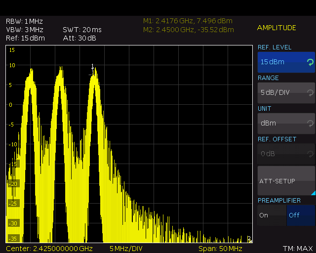

I just installed the 3.0 firmware on my Devo 7E, it is working with my Ladybird v2.
I measured the output power of the Tx with the original firmware and the Deviation as well. The power is the same, about 4mW. For reference, my Futaba and Frsky radio both have 40mW output.
While this 4mW is more then enough for normal piloting, it's low for FPV. I installed a 200mW 5.8GHz video Tx to the Ladybird, the video range is far longer, the RC range is only about 100m.
(the claimed 500m range maybe true for a normal receiver but not even close for the Ladybird)

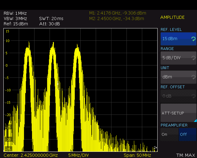

I ordered a 8s module, I think it's easier to build in the modul then trying to increase the power of the existing one.
Screenshots of the Hameg spactrum analyzer:

19 Apr 2013 13:55 - 19 Apr 2013 13:59 #9055
by mmormota

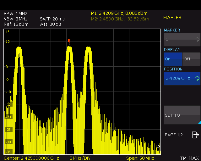

Replied by mmormota on topic Devo7e work
I modified the the buil-in module using this instructions:
www.deviationtx.com/forum/3-feedback-que...-7e-for-better-reach
thanks Mullson for the idea.
Success, the output power is ten times more, about 60mW, it's even more then the power of my full range Futaba and Frsky radio.
There is a 10dB attenuator on the spectrum analyzer to protect the input, so add 10 dB to the value on the picture, the real power is 18dBm.

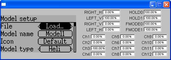

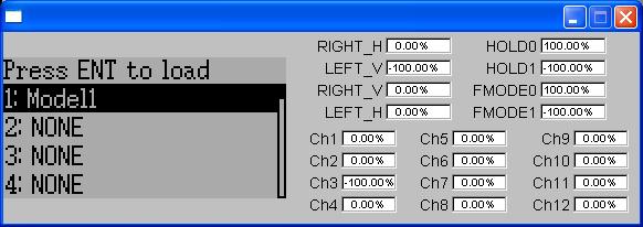

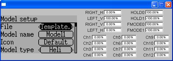

Installed 3.0.0 release on my Devo 7E. Have two questions:
- Does it support model switching? If yes how to: see models list, switch models?
- How to use templates? - could't find "Templates" section in the "Model setup" menu

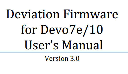

- zhesto

29 May 2013 06:30 - 29 May 2013 06:36 #10386
by zhesto
Replied by zhesto on topic Devo7e work
Yes, I read it several times and there was nothing mentioned about these topics. The manual is not 7E specific, like you can see even the title is 'Deviation10UserManual'. STFG too.
The videos on YouTube all showing touch screen interface, but Devo 7E does not have that features (touch screen, multiply models, templates etc.), that's why I'm asking here (thought there is something 7E specific, like the different .ini file format).

Thanks rbe. Helped a lot. Interesting is, that it is displaying only the models in the new .ini format - I have model[1-30], but it's displaying only the first one, because it is in the new format. Hm, or it is just checking if the file contains 'name=...' line...Never mind. thanks a lot again.
29 May 2013 08:57 #10394
Replied by rbe2012 on topic Devo7e work
It should show all, but only the first or those you have configured will have a name set.
When you update to other deviation versions you should always
- save your models to pc
- copy the model files delivered with the newly installed versions to "models/"
- restore your models (but only those which are configured, not the empty models) to the tx (if you restore the empty models too they might not contain new parameters / defaults)

29 May 2013 09:39 #10396
by zhesto
And specially for 7E - restore 'protocols/' directory too
29 May 2013 09:56 #10397
Yep - you see my knowledge results from a theoretical point of view. I have only an emulated Devo7e...

29 May 2013 15:11 - 29 May 2013 15:11 #10405
by RandMental
Just make sure you have the latest V3.0 manual, looks like you have an older version, as the latest says Devo7e/10:
Replied by RandMental on topic Devo7e work
zhesto wrote: Yes, I read it several times and there was nothing mentioned about these topics. The manual is not 7E specific, like you can see even the title is 'Deviation10UserManual'. STFG too.
