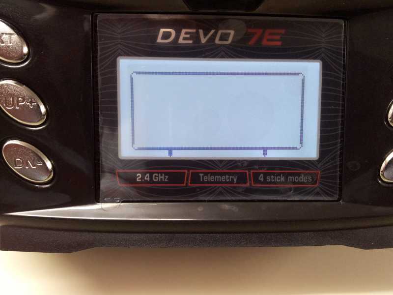

01 Apr 2013 20:19 - 01 Apr 2013 20:31 #8403
by RandMental
Replied by RandMental on topic Devo7e work
Hi Guys
I have spend a few hours now trying to get Deviation on my 7e. I have no problems on my Devo8s to load and run Deviation.
Loaded the latest nightly or one that I build locally for Devo7e, same results...
I loaded the DFU, formatted the drive, load the directories under the Filesystem Directory and copy the Protocols directory to the root, and changed tx.ini for the diode mod.
The screen however only shows a block (see below) and after a few seconds the backlight turns off. I went back to the Walkera firmware and all works as it should. Again back to the Deviation, same result.
Am I missing anything on the Devo7e upgrade to Deviation?
EDIT: below also now the errors.txt for today's nightly build, plus the required elf files, just in case
Last edit: 01 Apr 2013 20:31 by RandMental.
01 Apr 2013 22:22 #8410
Replied by PhracturedBlue on topic Devo7e work
I need the elf file that came with the firmware (devo7e.elf). You only provided the elf files for the protocol modules, which isn't sufficient. Generally what you see is a little weird. the dialog box you see doesn't look like deviation dialog (which should have 2 parallel lines in the corners.
what you'd normally see if there was no filesystem. the little bars at the bottom look somewhat like the trims but the bounding rectangle is missing. I think it crashed before finishing the display (though in that case it should go into a reboot loop. You errors.txt does appear to contain a crash log though. If you provide the devo7e.elf with it I can debug further.

02 Apr 2013 00:33 #8413
by farad
I had the nightly 7e filesystem but I replaced it with the devo 10 filesystem and that fixed the issue.
Replied by farad on topic Devo7e work
sbstnp wrote:
farad wrote: I tried the most current nightly build and I can't see the graphs on any screen.
Replace the filesystem too.

NOTICE
We have confirmed the Devo 7e File System is not correctly generated in the current nightly builds or when built from the current source files. PB is working on it.
In the mean time the workaround is to load the Deviation for the 7e as normal per the manual, but copy the Devo10 file system directories, excluding the languages directory. Do not use the Devo 7e file system. Remember to copy the Protocol directory from the 7e build to the root directory as well.
