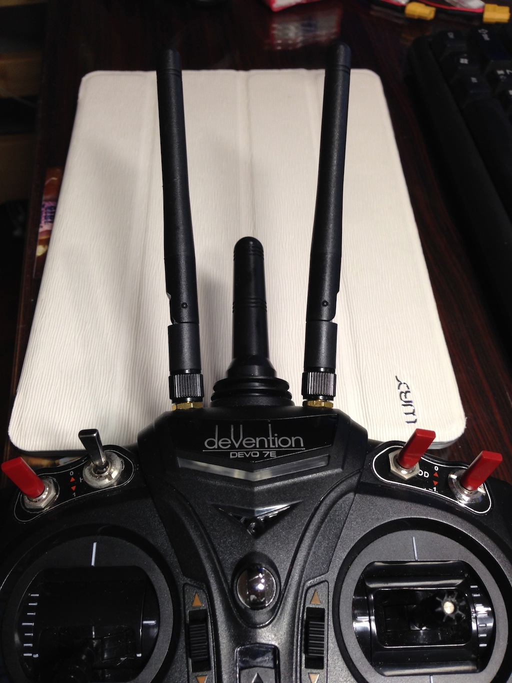

All parts have arrived. I'll try to build the multi-module this weekend into my Devo 7e. How did you guys place the antennas? I already have added 2 antennas on it. I'm thinking if I should try to drill another hole to fit the 3rd antenna, or just place a thin wire into the plastic tube for the original antenna. Below photo is my original Devo 7e mod with 2 additional antennas.

12 Jul 2014 18:27 #24543 by phantom8
Replied by phantom8 on topic Developing a universal module
aMax wrote: The best way to discover this,is to go back to a previous version....;-)
Yesterday I finished my NRF24 mod and it works great with a JXD388.
Lights on/off, flips, and three speeds ( 3x2 switches), all with that
models (2x2)I have found here. Old software (devo7e-v4.0.1-ac4f0b2)
Multi modul stays commented.
BTW , how did you connect the antennas, U.FL or soldering?
My available sockets only have that thin 1.13 cable and I don`t like to solder it.
My previous version is a bit old and doesn't work properly with MM. The antennas are connected via u.fl connectors.
