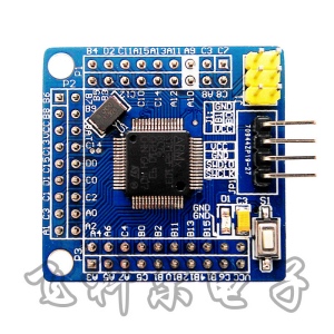

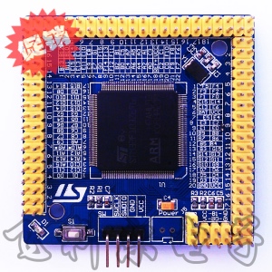

First of, you really should post this request to Wishlist for a custom Transmitter board . But CK is right about this. You probably won't find traction for doing this.
Firstly, I2C is not the protocol that I would choose for the LCD. You will likely run into refresh issues as it is generally slower than SPI. In fact, I believe the 7e is the only model that even has SPI, as the rest are using the much faster parallel interface.
Secondly, if you are looking for low cost alternatives then the OLED SPI modules have already been successfully used with the 7e with little or no code changes. See this youtube video .
Finally if you want to go colour, then the ili9341 FSMC based LCDs (already supported in the code) would be your best bet for something low cost. You can find them with XPT2046 SPI touch controllers, which I believe can be made to work with the current code. Some mods may be needed, I've not really tried, only looked at the datasheets.
It's great that we have another hardware guy around that can slap custom PCBs together. If you are intent on building our own, I'd really suggest going with one of the 100 or 144 pin variants. The 64 pin is doable, but you'll quickly run out of pins and getting other people interested in the project will be harder because everyone wants everything in their TX... literally
As for small sized dev boards, here's the 2 that I have. the RET6 is 35mmx35mm and the ZET6 is 50mmx50mm.

- Cereal_Killer
26 May 2016 17:32 - 26 May 2016 17:33 #49298
by Cereal_Killer
Replied by Cereal_Killer on topic Ultimate7e tutorial: Processor upgrade
SS can you provide a link to the first [smaller] one? Do they sell to regular dudes like us with MOQ=1 or some sort of "agent"?
I've only found this that's about 50x65mm but I can't navigate all those Chinese only seller sites like you guys can.

- silpstream
- Posts: 244
26 May 2016 17:56 - 26 May 2016 17:59 #49302
by silpstream
CK, here's the link:
https://item.taobao.com/item.htm?id=39081190681
It's unfortunately a Chinese only site (taobao.com). Both boards are from the same seller. He will sell in quantities of 1, but you'll have to go through an agent to get it to the US.
Make sure you choose the ones with the chip model followed by "成板“ i.e. "STM32RET6成板". That's basically the complete board. The PCB only is "STM32系统板空板".
If you run into issues with an agent or ordering, let me know, I can order it here and send it to you.
Note, mine had some silkscreen errors for the pinouts, but you'll figure it out fast, just compare the sequence to the data sheet. I had this as an upgrade for CleanFlight, before the SPR F3 board was released.

- HappyHarry
- Posts: 1136
26 May 2016 18:13 #49303
by HappyHarry
Replied by HappyHarry on topic Ultimate7e tutorial: Processor upgrade
silpstream bud where did you source those dev boards? as the smallest zet6 i could find when i went looking was this one >>
www.aliexpress.com/item/Free-shipping-ST...13010308.0.54.NXIs9Y
which is 71x65mm
