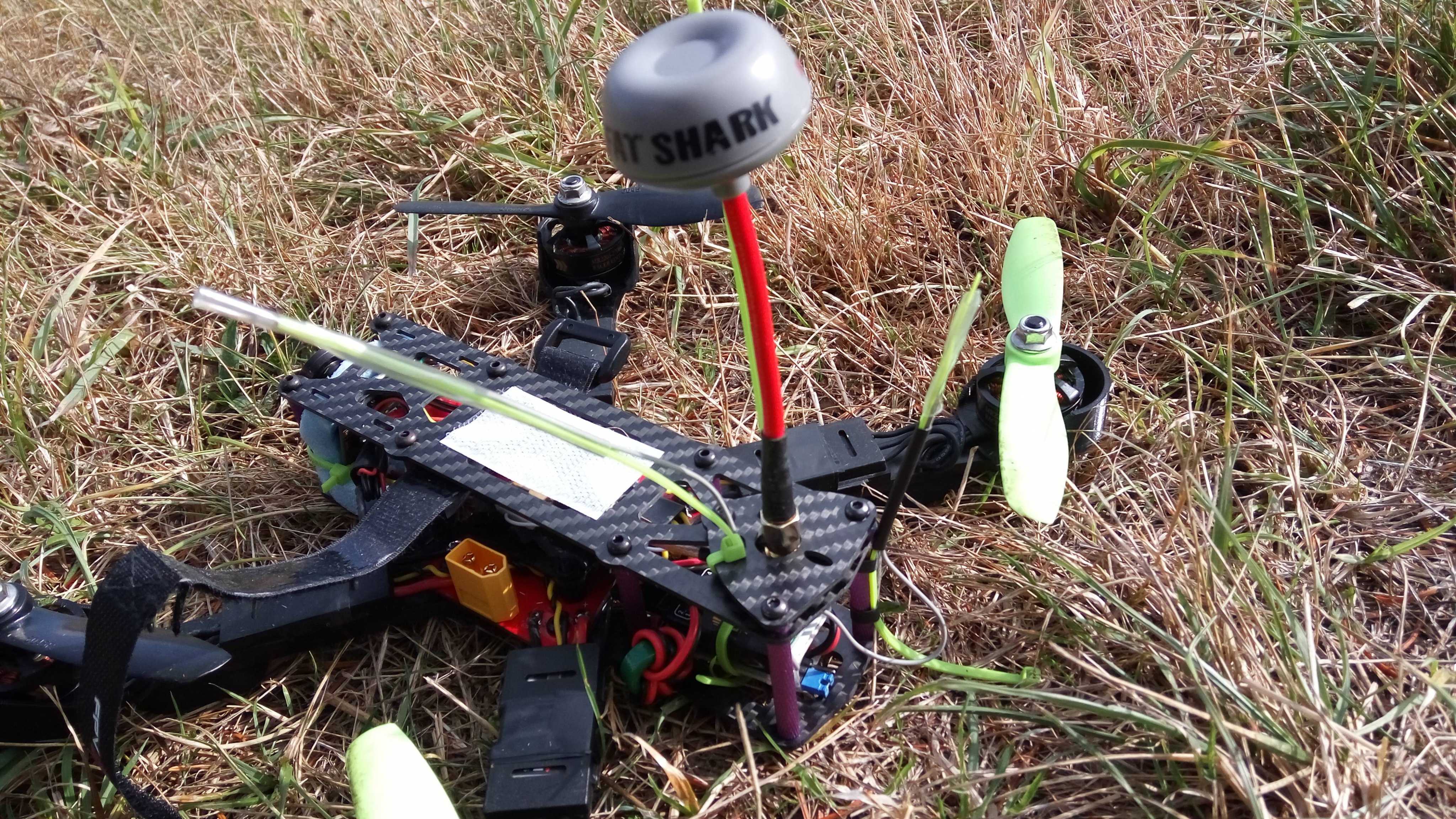

17 Oct 2016 20:52 - 17 Oct 2016 21:50 #55073 by aMax
Replied by aMax on topic Frsky compatibility
Any photo available of your quad and the mounted receiver?
Edit:
I already posted this link , but I think, it is worth doing it a second time.
In the near-field it has no big influence of the connetion quality (reflection etc) but at longer distance it comes to the point.
Edit2:
Since you have a D4R-II, the best orientation for the antennas will be in parallel and upwards, maybe a little tilt backwards because of the angle your quad is flying at a certain speed.
Why? This receiver has two antennas, but one is for receiving and one for transmitting the telemetry.
Last edit: 17 Oct 2016 21:50 by aMax.

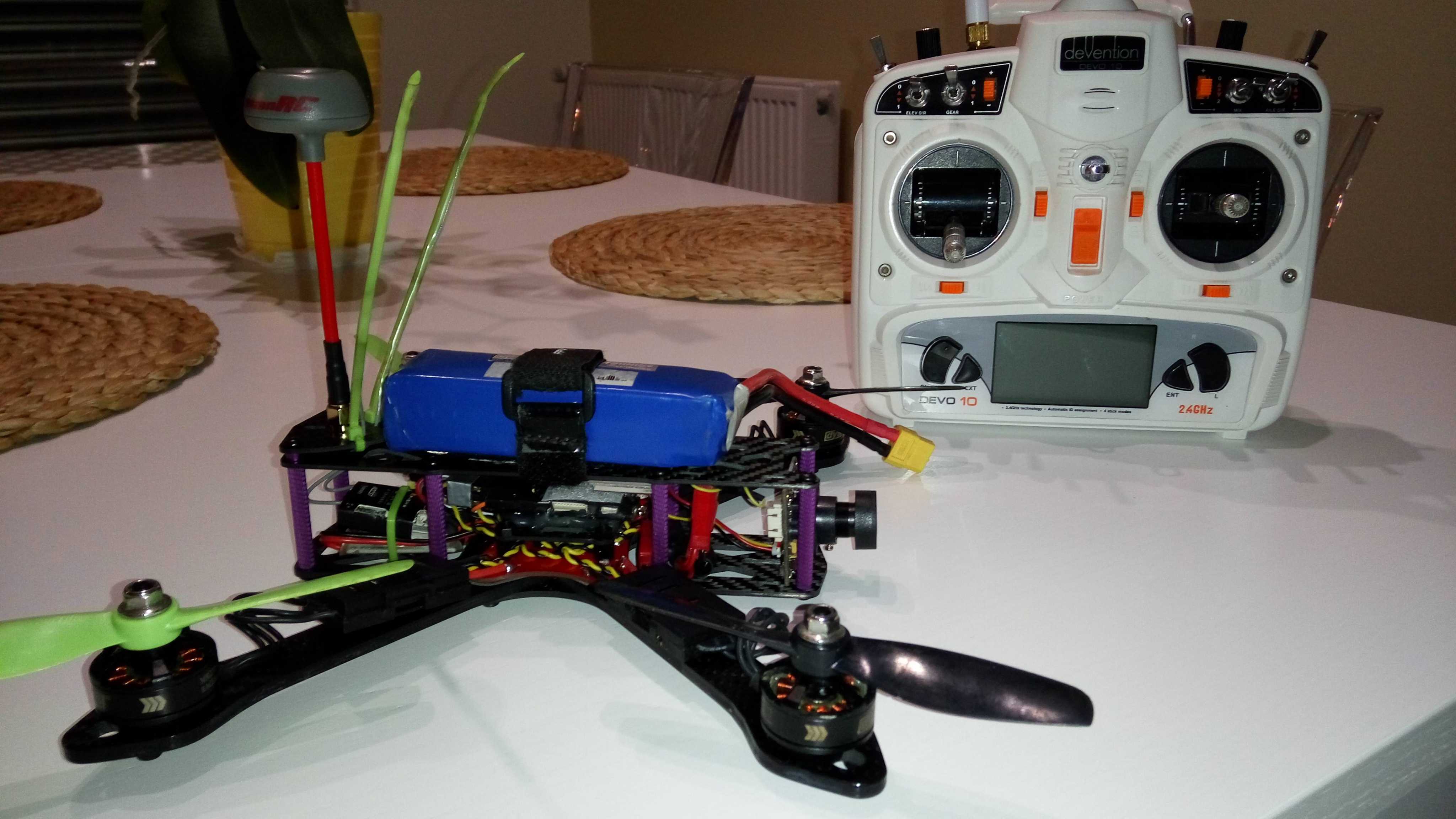

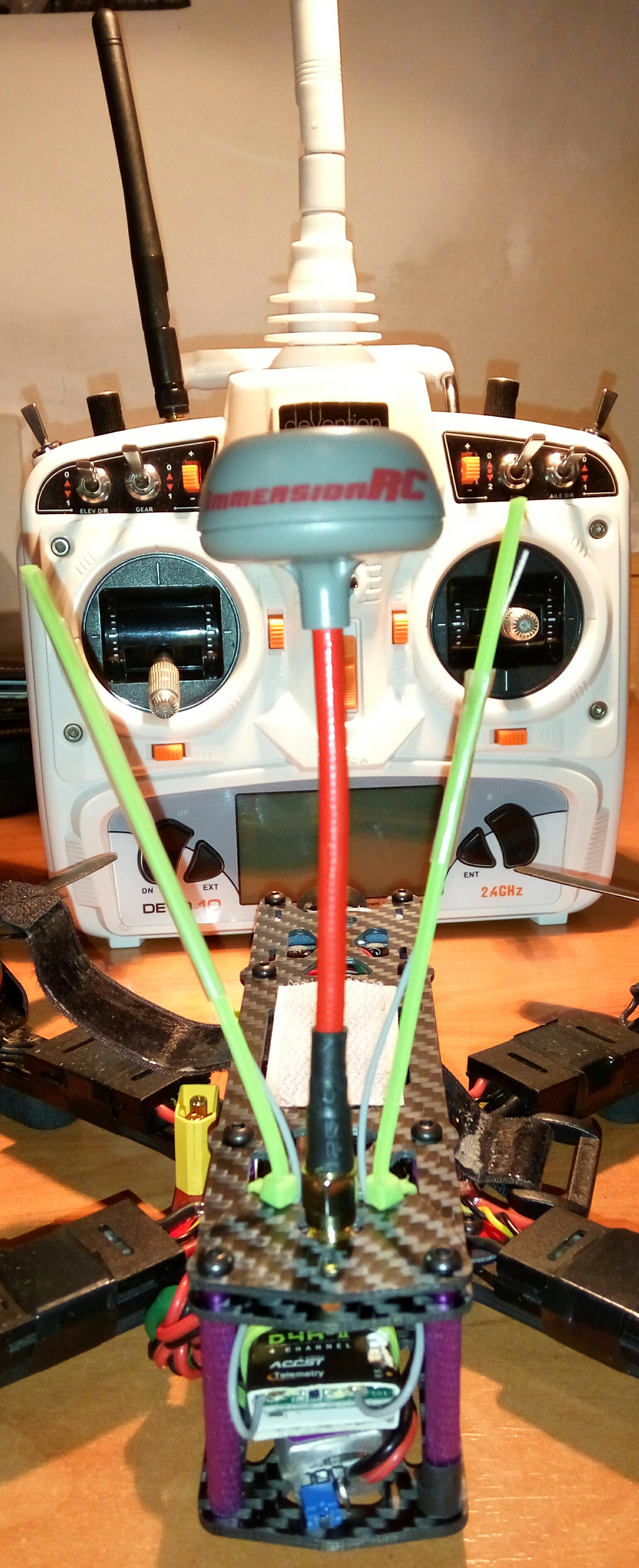

18 Oct 2016 08:46 #55086 by sfersystem
Replied by sfersystem on topic Frsky compatibility
aMax wrote: Any photo available of your quad and the mounted receiver?
Edit:
Edit2:
Very interresting, Thank you
But I hardly believe that the location of the antenna divided by 4 the scope of this rx, i think it's something else in conbination.
Here the mount
18 Oct 2016 09:34 - 18 Oct 2016 10:25 #55087 by aMax
Seeing your white Devo10 ( high gain antenna) I have no idea at the moment what reason could be.....
I get 700m out of my cheap DIY rx with a single dipole mounted like this.
static.rcgroups.net/forums/attachments/5...7-1vlcsnap-00201.JPG
Edit:
The only difference could be in the RF module you are using, because Arakon and I have the blue one from BG and no finetune was necessary.
To watch his flight search Arakon on YT and " Flight to the castle" (one year ago)...... (Devo7e and D4R-II)
Last edit: 18 Oct 2016 10:25 by aMax.

18 Oct 2016 16:10 - 18 Oct 2016 16:23 #55104 by aMax
If you had placed the one on the top like you did with one straight at the back, I think it would have been fine.
Remember, both should have the same polarization as the antenna on the transmitter!
Last edit: 18 Oct 2016 16:23 by aMax.
