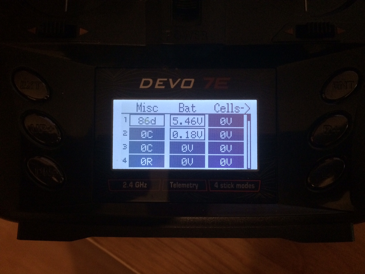

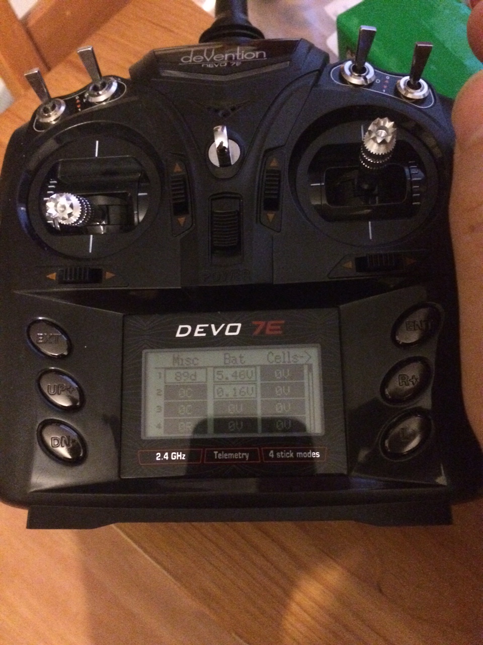

20 Sep 2016 07:20 - 20 Sep 2016 07:52 #54051 by Pegaz
Replied by Pegaz on topic Frsky compatibility
Thank you hexfet for your interest and help - here are some more details:
Reading above post and folowed petsmith's hints I decided to use soft serial1 instead , and made sure telemetry_inverted is ON in CLI. Softserials are ok as i got GPS connected to softserial2 and it's working fine so i assume softserial1 is OK too. I'm using FrSky protocol and the telemetry is on (keept all those setting inside the protocol as default, no fine frequency tunning etc, it binds OK)
I've got "telemetry" slider in cleanflight "on" as well. Softserial1 in cleanflight settings has FrSky telemetry selected and baudrate set to "AUTO", Green wire from D4R-II which is RX is connected to 4th pin from the end on AfroFligt32/naze32 rev6 which is sofserial1 TX. Running HappyHarry's 256 build from the 7th of sept. Do I need to modify hardware.ini or anything else in the Devo 7E to "enable" extended telemetry ? I've got not clue why this bloody thing is not showing up. I did try on armed/running , and disarmed- nothing apart from those 3 fields in the pictures displays :( Don't know if it matters but i've resored "models" directory, hardware.ini and tx.ini from normal not 256kb version of deviation
This is my board:
Last edit: 20 Sep 2016 07:52 by Pegaz.

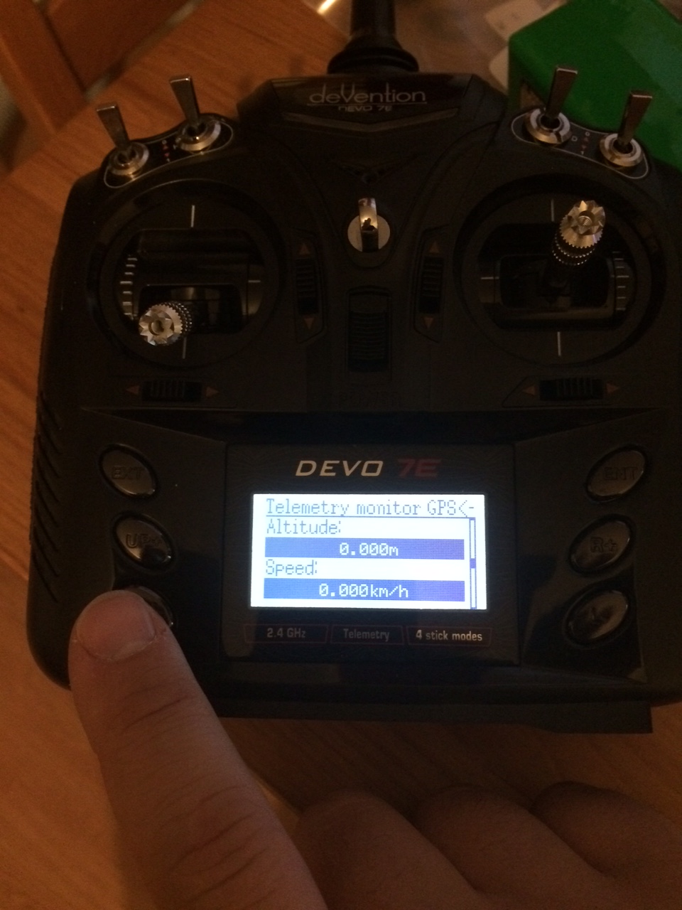

20 Sep 2016 07:41 #54052 by aMax
Replied by aMax on topic Frsky compatibility
Did you try the "UP" button on the left to switch to the Latitude-Logitude gps section?

23 Sep 2016 19:43 - 23 Sep 2016 19:45 #54183 by Pegaz
Thanks hexfet,
A bit on an updates:
I have flashed with your test build but still no luck, and then i went mental and started doing weird things. I have moved telemetry connection to softserial1 RX pin (labeled nr. "6" in the picture of my board that i've attached in previos post) i know it sounds ridiculous as i should be "sending data out from the FC board to the RX" not receiving them BUT it started working after a while!!! Can someone explain me that? I've checked the same thing on a different board (naze32 thin running iNav) and after moving connection to Rx from TX it started working too! I flashed back to the latest HappyHarry's biuld and it worked too. It doesn't make any sense for me- two differnt boards , two different firmwares. Also the telemetry resfresh is VERY slow it makes it almost unusable to check the speed and altitude. Is this how it suppose to be? Any chance to have a 'live' data??

25 Sep 2016 00:02 - 25 Sep 2016 00:03 #54227 by Pegaz
Unfortunately , i don't know and have no idea how to check how often the naze is sending the telemetry updates, but it's all very slow .
