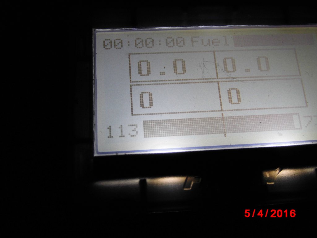

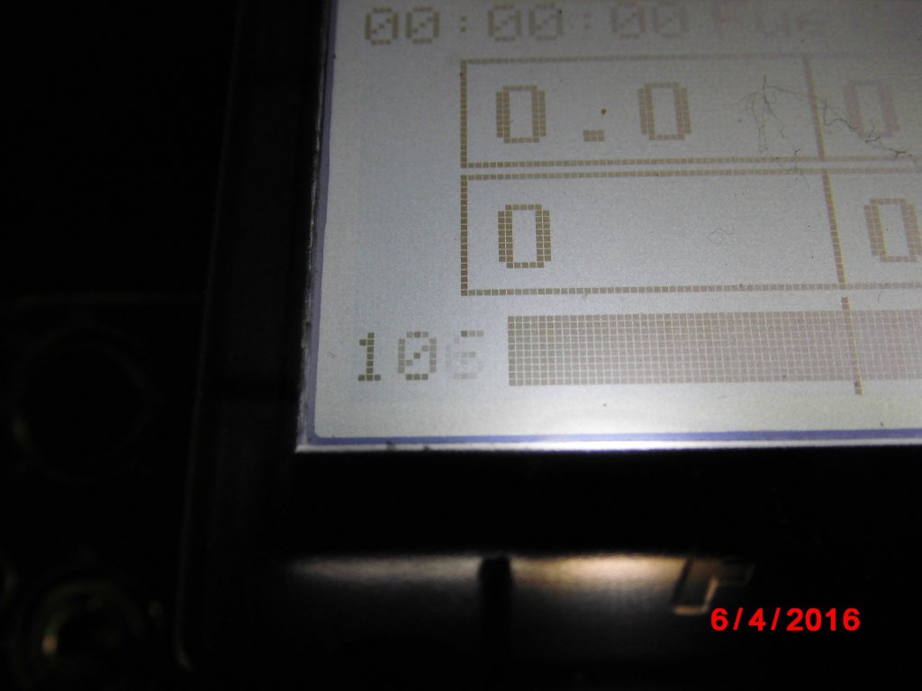

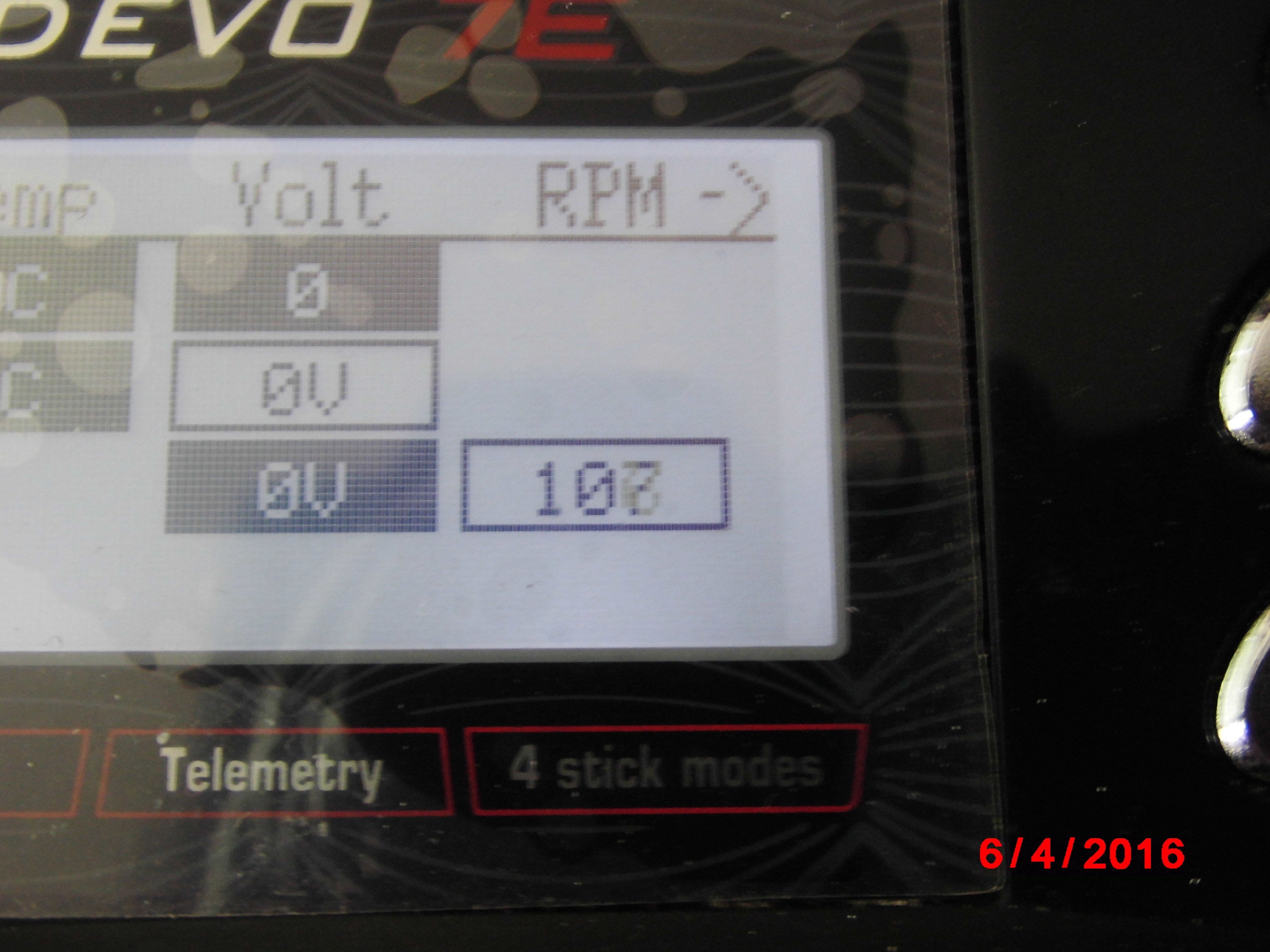

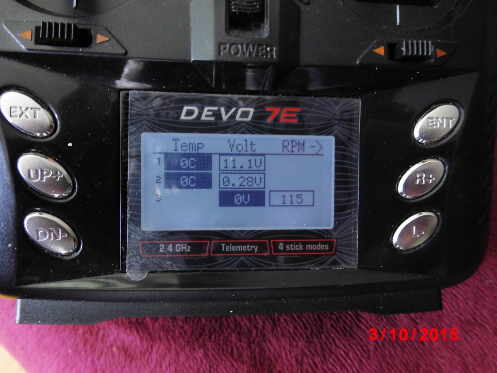

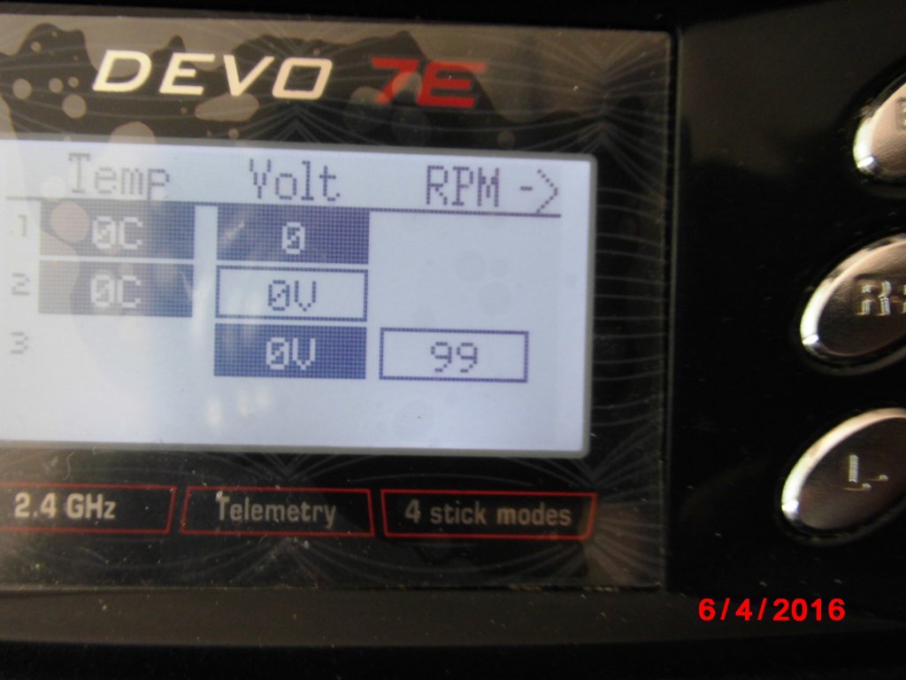

Can anyone tell me if the RSSI output has been recalculated since the nightly of 1.October (devo7e-v4.0.1-2cde795)?
The rx value on my 7e was all the same as on the FLD-02, but now with version devo7e-v4.0.1-f5d851e it is less.
Old (2m distance) >115 to 121 and now 99 to 105.
To verify this I used two receivers of the same type for testing.
Bear with me if I missed a posting on that.

My accidental merge of my FrSky telemetry rework was backed out since then. Since I'm not sure when that happened, I can't say if that was already in what you had before. I also don't think that change included a change to RSSI calculations.
One quick check - did the old version present it as a percentage and the new one as a dB value? If so, then the calculations changed from SebyDocky's percentage to use FrSky's RSSI values.

Only digits, no notation...
Long story short, if I find some time i will reflash the Devo and take my DFT & the FLD-02 as reference.

Flashed back and forth, no noticable difference. So the special nightly seems not to cause this issue.
The main reason might be a newer firmware version on the receivers which I had flashed after the second one arrived.
Sorry, forgot about it.
Well, they give me different readings, 101 vs 107(older one, different antenna cable).
The DFT is now in the same range.
In addition it is most likely I even used an older nightly on the first testings.( July??).
I have to investigate on this.
Hence I will stop here and continue at RCGroups( rx firmware)
Thanks for attention.
