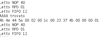

23 Jan 2015 01:46 #27941
by ig0rb
Replied by ig0rb on topic New WLToys Protocol V977
I've got IT !!!
My mistake was that i didn't matched the address but the payload with arduino library.... I wrote the functions to access to the nrf24l01 and it's work... i can see the correct binding packet
Thanks a lot for your code and your support

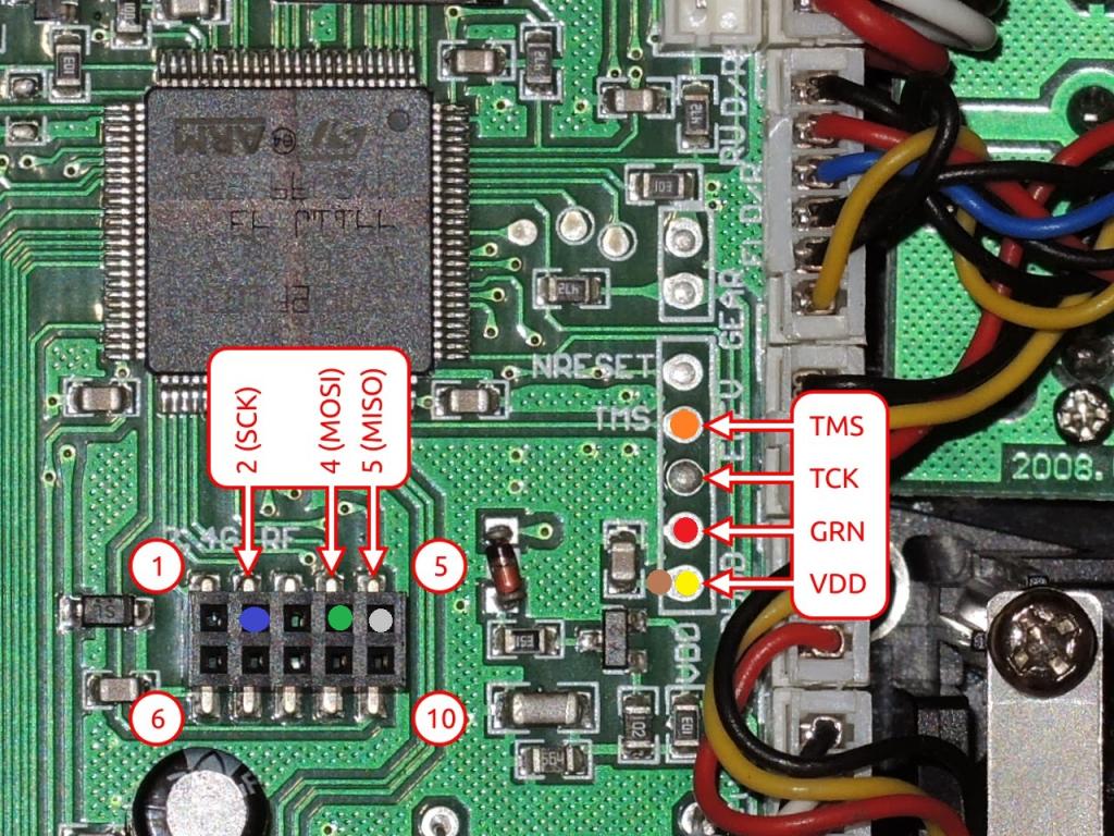

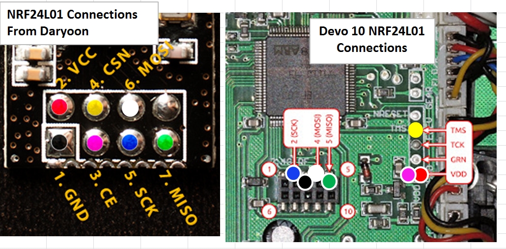

Hello everyone
recently got t v977 bnf from banggood with the nrf module.
The soldering was done ok I would say but for me is still not clear(seen several versions) if from the nrf module the pin5 ground must go to the walkera module pin3 as below or not? This is how I did mine:
I loaded this nigthly build which for me is still a bit of mistery due to missing documentation and I can say that sometimes the bind just gets lost between my devo 10 and the heli. Another issue I have is that I could never get to take off since either the motor doesnt start or when it spools up it suddenly stops(pitch still changes even if motor is stopped). Another issue is that sometimes on startup I got the "program update" logo that the dfuse process gives - without updating anything and also I got some missing module error message.
To be honest much fuss and big chances to fail on the transmitter or loose the bind and heli mid-air...I know also this build is supposed to be unstable but I could never trust glying my 500 heli with this just expecting some binding loss or some restart furing flight. Tried going back to stock firmware but got some strange font error.
Please let me know if my pinout is correct or not, and / or if I am doing something wrong here?
