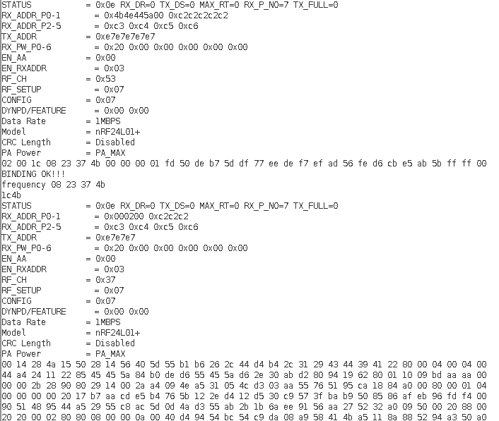

20 Jan 2015 01:34 #27869
by ig0rb
Replied by ig0rb on topic New WLToys Protocol V977
Hi, I'm Igor from Italy, I taken a look to the very interesting work on deviation tx... and i'm trying to understand the KN protocol...
I wrote a simple sketch with arduino to log the V977 TX.
I read the protocol specs and the implemetation code of KN on bitbucket...
I have some troubles... I can see the binding packets , trasmitted from the TX, I identified the TX id, and channels that are used for frequency hopping, but when I try to open the first channel I cannot recognize correct data.
The ID of my TX is 0x00 0x02 0x00 0x1C 0x4b (??? is 4B static as i saw from the code)
If I open the readingpipe with 0x0002001c4b LL (uint64_t) i can't see data...
Instead, if I open the readingpipe with a 3byte address (with radio.setAddressWidth(3)) 0x000200 I can see some data....
but... I don't have the correct address matching, I can see something related to stick movement but the position of the date is not correct...
I attach a screenshoot of my log.
I disable enchanged shockburst
I disable ACK and CRC, just to 'sniff' data.
In the attachment you can see my NRF24L01 settings on startup, before binding matching and after binding matching.
Do you have some idea of where i did the mistake?
Thanks a lot to all
Thanks a lot to all

- victzh
- Posts: 1386
20 Jan 2015 20:09 #27899
by victzh
Replied by victzh on topic New WLToys Protocol V977
As far as I can tell, you are trying to make an Arduino receiver, aren't you?
Why did you disable CRC (disabling ACK is OK, there is no ACK in the protocol)? It affects the packet received and you're lucky you got any packets at all. What's the nRF24 library you use? I found maniacbug.github.io/RF24/classRF24.html , is it correct?
I suppose it is so, but then your address handling is wrong. You use wrong bind address, correct one is "KNDZK", or 0x4B4Eee5A4BLL, and wrong protocol address - it is read from binding packet bytes 4, 5, 6, 7 and the last byte is always 'K' or 0x4B. It is also 5 byte long as the binding address, not 3 as is in your code.
Basically, you should not radio.setAddressWidth(3) and you should use radio.openReadingPipe(0, t) instead of radio.openReadingPipe(0, 0x000200LL). May be you should convert t to uint64_t.
- ig0rb
- Posts: 4
20 Jan 2015 22:25 #27908
by ig0rb
Hi thanks for your reply, I disabled crc because i wanted to see 'raw' data on serial line.... using short address permitted me to see raw data and some noise.
if i understand well from the repo enchanged shockburst, ack payload and ack are always disable ?
yes i'm using this library but i extended the class to read and write registers directly....
kndzk is the correct address but sniffing raw data i see 0x00 instead last k...
Tomorrow i will try another module... i also putted a 100nf from vcc to gnd on the module....
sorry for my english , I'm writing from mobile.
- victzh
- Posts: 1386
22 Jan 2015 06:46 #27929
by victzh
Short address filters some data you're interested in anyways - suppose you have an address starting with something beyond 0x00, 0x02, 0x00 - you'll miss all these packets. You're right about ACK - they're not used for this protocol.
