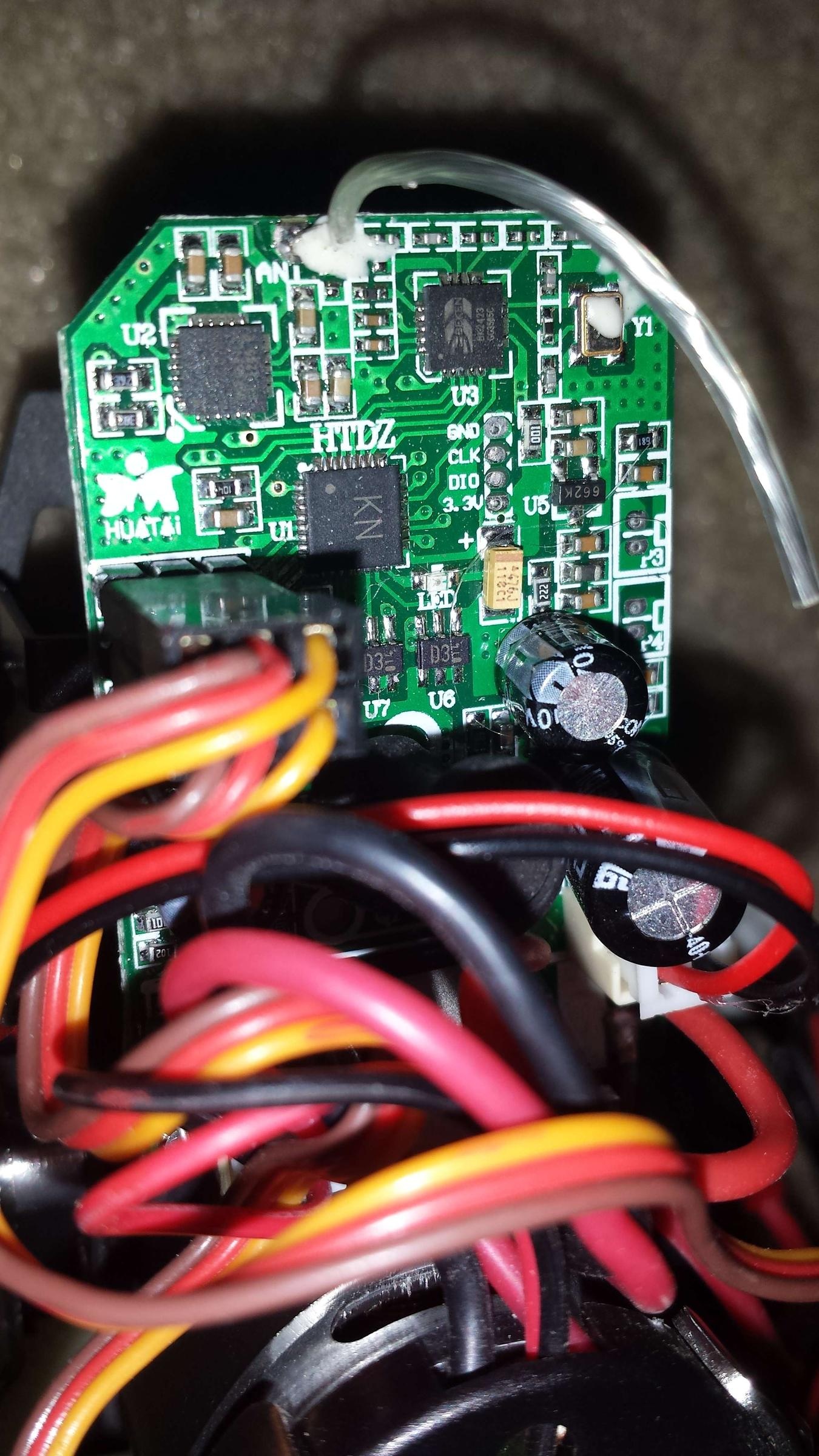

I'm try to find out if the pcb from FX071c indicates whether or not it is using the KN protcol. And if the v977 tx might be compatible or the deviation software, devo 10, and NRF24L01 module.
Last edit: 07 Jul 2014 01:43 by ricchrist.
07 Jul 2014 05:48 #24449 by victzh
Replied by victzh on topic New WLToys Protocol V977
It's more or less written on a chip - KN. Also, it uses Beken as a radio chip which is also a sign of KN protocol.
So yes, signs are there. They can change some detail so it is incompatible, so the best way to answer your question is to try it.
And yes, Devo10 works great with KN compatible helis (I have only V977, but people reported others to work as well).
