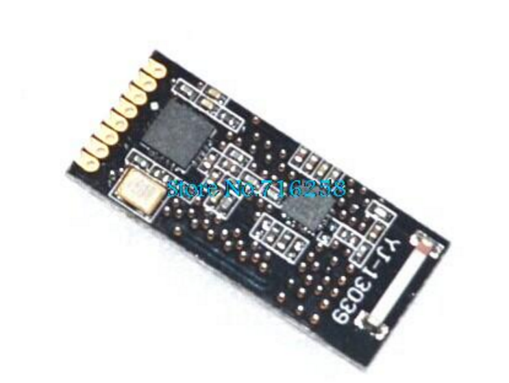

This part might be a little out of topic, but the NRF24L01 i used was with a ceramic antenna .
I did a range test at 10mW which was stepped down to 100uW, and still had no problems at 10 m range.

Hi wukong
I have a couple of questions please if you don't mind, just for information purposes I'm using a Devo 8, in an effort to avoid carrying an extra Transmitter around I would like to use the Devo 8 to fly the V977, I have the deviation software installed on the Devo 8, I don't fly the V977 any further than 50 feet (13 meters) to either side of myself.
I was wondering if this module has worked out well for you?
If I'm understanding this correctly with this Module there's no necessity for an extra antenna?
Is there any special hardware involved with programming this card or does the deviation software take care of this?
Edit: my apologies this is my first post trying to add a quote, I'm not sure what I did wrong but the quote from post #4156 did not get included, the module I am referring to is the one with the ceramic antenna in post number 41569 by wukong.
Thank you.

24 Feb 2016 17:04 #43562 by wukong
Replied by wukong on topic New WLToys Protocol V977
Don B wrote: Hi wukong
Thank you.
Don B
Hope you didn't wait too long for my reply. Let me try to answer your questions:
1. Has this module worked out well for me?
Ans: Yes, it works fine without any issues. However, i realized that if i ran it on 10mW or higher, i tend to get drop connections every once in a while. I suspect it's due to overheating or the fact that the module is a low powered one and 10mW is too much power, because I stopped experiencing it (over 3 hours of flight time now and counting) after i set the transmitter power to 3mW.
Even at 3mW, I still can fly it more than 20m without problems. (at 20m i'm struggling to see the v977!) I also did a range test at 100uW and it still worked at 10+m range (I was too lazy to go further.. =p) Since you fly no more than 15m, this should work fine for you.
Other members have tried and recommended this other module which comes with an antenna: www.banggood.com/DEVO-Transmitter-Tuner-...ys-V922-p-89812.html For this banggood module, you can keep the antenna within the Devo casing also without any issues.
2. There's no necessity for an extra antenna?
Ans: Yes, indeed! Just install the module and good to go, no need to fiddle with any antenna. Some members have also tried the circuit board antenna (similar to this module) with good results.
3. Any need to program the module? Or does the deviation software take care of this?
Ans: As with most other antenna modules, there's no need to program the module. Just follow the installation instructions very carefully and you should be good to go. Some soldering required, followed by flashing the Devo transmitter to Deviation firmware. Remember to use the latest nightly.
Let me know if you have further questions!
24 Feb 2016 19:41 #43576 by Don B
Replied by Don B on topic New WLToys Protocol V977
wukong wrote: Hope you didn't wait too long for my reply. Let me try to answer your questions:
I didn't wait too long I just posted my question yesterday and Thank you very much for the quick reply.
I probably will go with the banggood one you supplied the link to, it's the one I was considering originally but I guess I was a little confused I thought the V922 was a different protocol so I wasn't sure if the module would work for the V977 so thank you for clarifying that.
The soldering shouldn't be a problem I've already had the Transmitter apart once to swap the positions of the throttle hold and idleup, after 30 years of flying RC helis my brain has the throttle hold on the right and the idle up on the left, I know I could have swapped the switches internally but that would have only left me with 2 flight modes if I used the switch on the left for idleup.
I really appreciate you taking the time to reply, though I have a lot of experience with RC's and Heli's in particular electric Heli's and this whole bind and fly thing is all new to me.
Don B.
