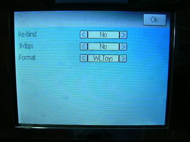

No, I only selected the KN protocol. Do I need to select WLToys format? Also how do I get it to it?
Last edit: 08 Dec 2015 23:49 by denis747.
- Birdman
- Posts: 280
08 Dec 2015 23:50 #40727
by Birdman
Replied by Birdman on topic New WLToys Protocol V977
tap on kn, it will bring up options

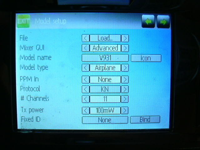

so i have:
nrf on tms a13
7105 on tck a14
attached pic of kn options screen
