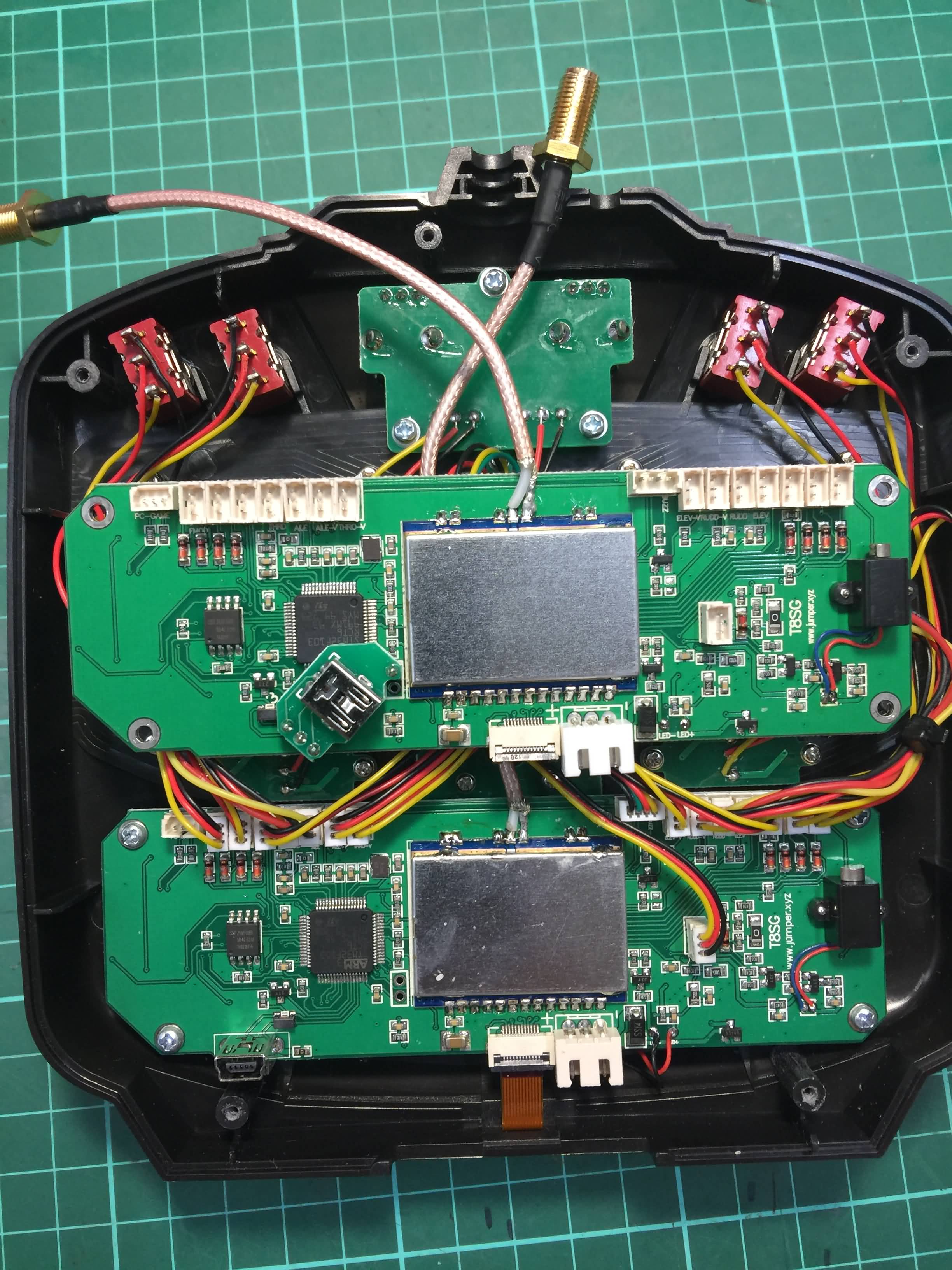

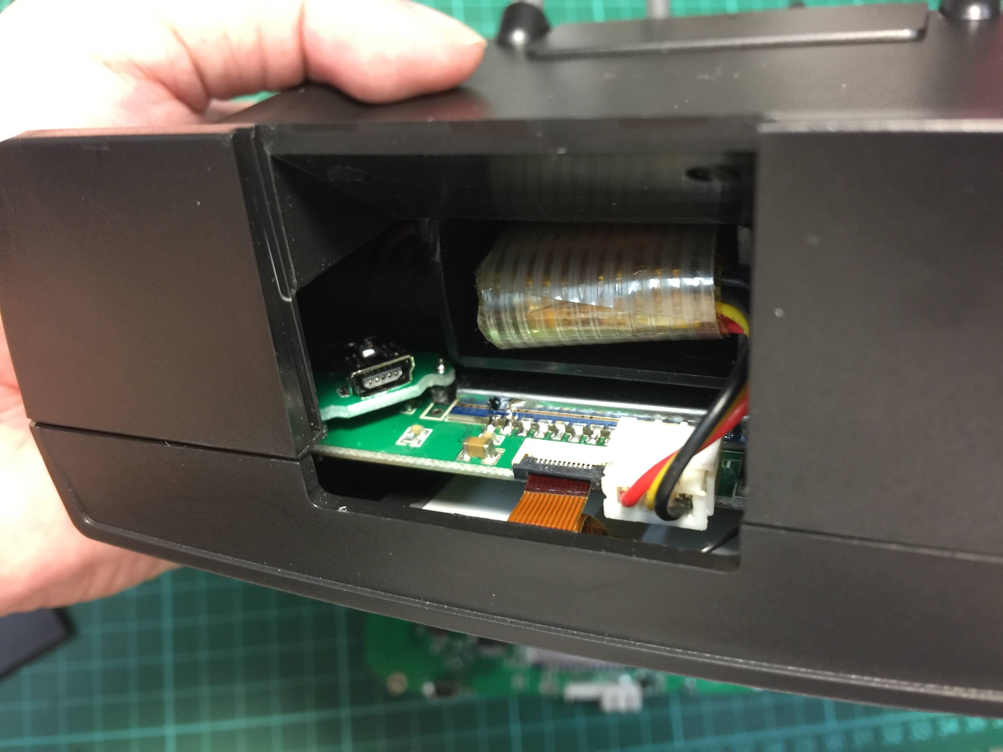

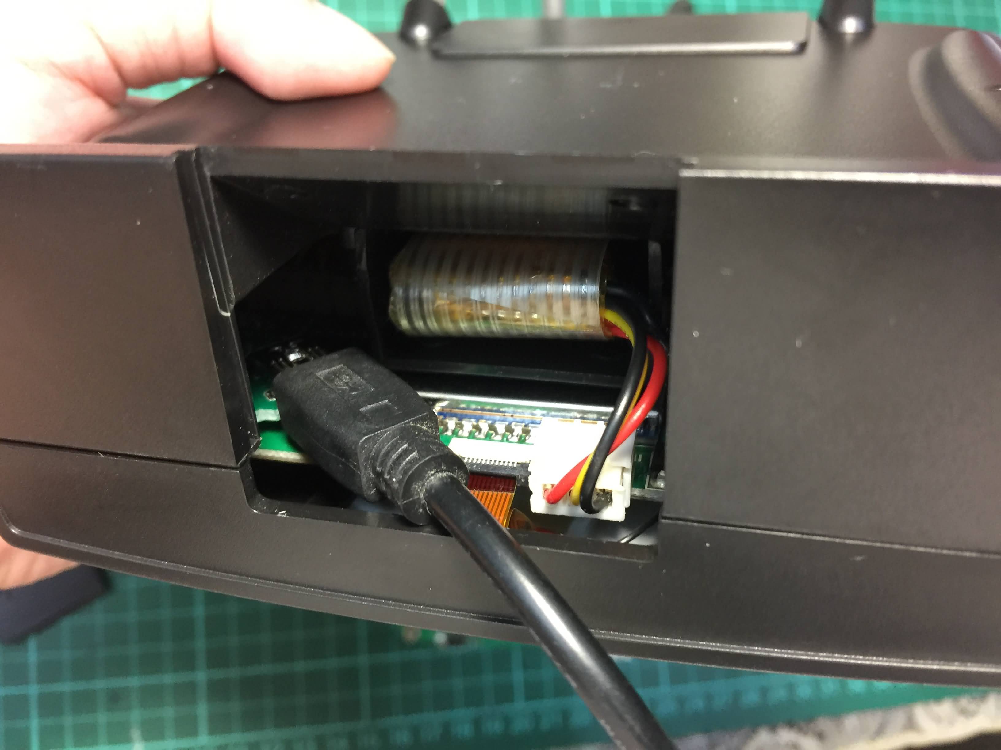

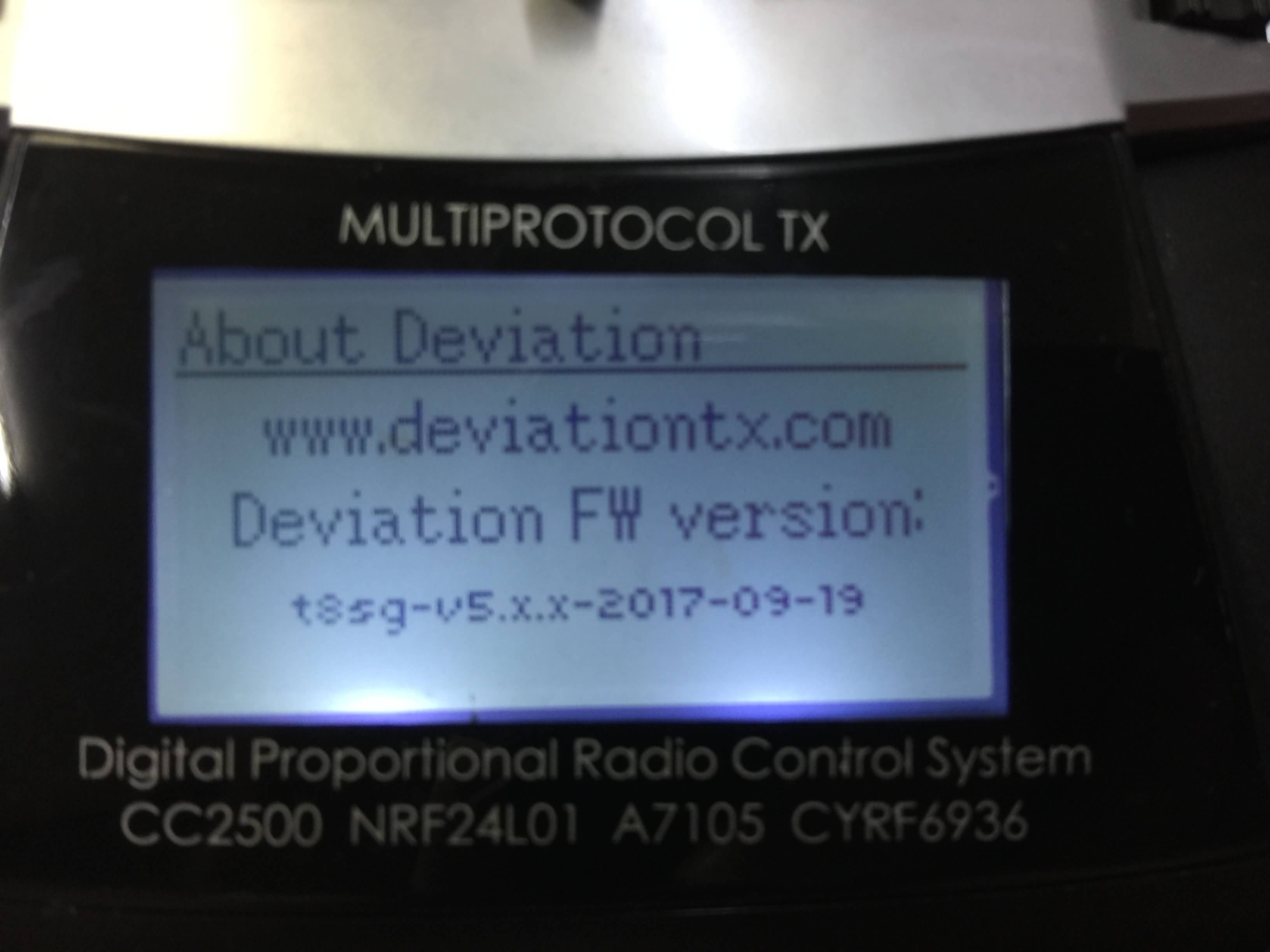

20 Sep 2017 00:05 - 20 Sep 2017 00:07 #64524 by dc59
Top : New PCB , Bottom : Stock PCB
Now we can plug USB cable , just open battery door.
Upgrade to vlad_vy's test build and it works fine , no need to reverse AIL/RUD direction.
Last edit: 20 Sep 2017 00:07 by dc59.
20 Sep 2017 00:12 #64525 by dc59
min54522 wrote: How do I upgrade my T8SG firmware?
Now "EXT + power on" on the black screen
I do not recognize the Debugging Tool. The driver installation is done. "ENT + power on" will recognize the USB driver. Does the T8SG have a firmware upgrade method?
"EXT + power on" you will see a all black screen , but it's not problem , just connect USB cable to PC/NB , use Walkera upgrade tool then upgrade FW(I recommand to use vlad_vy's test build here ) !

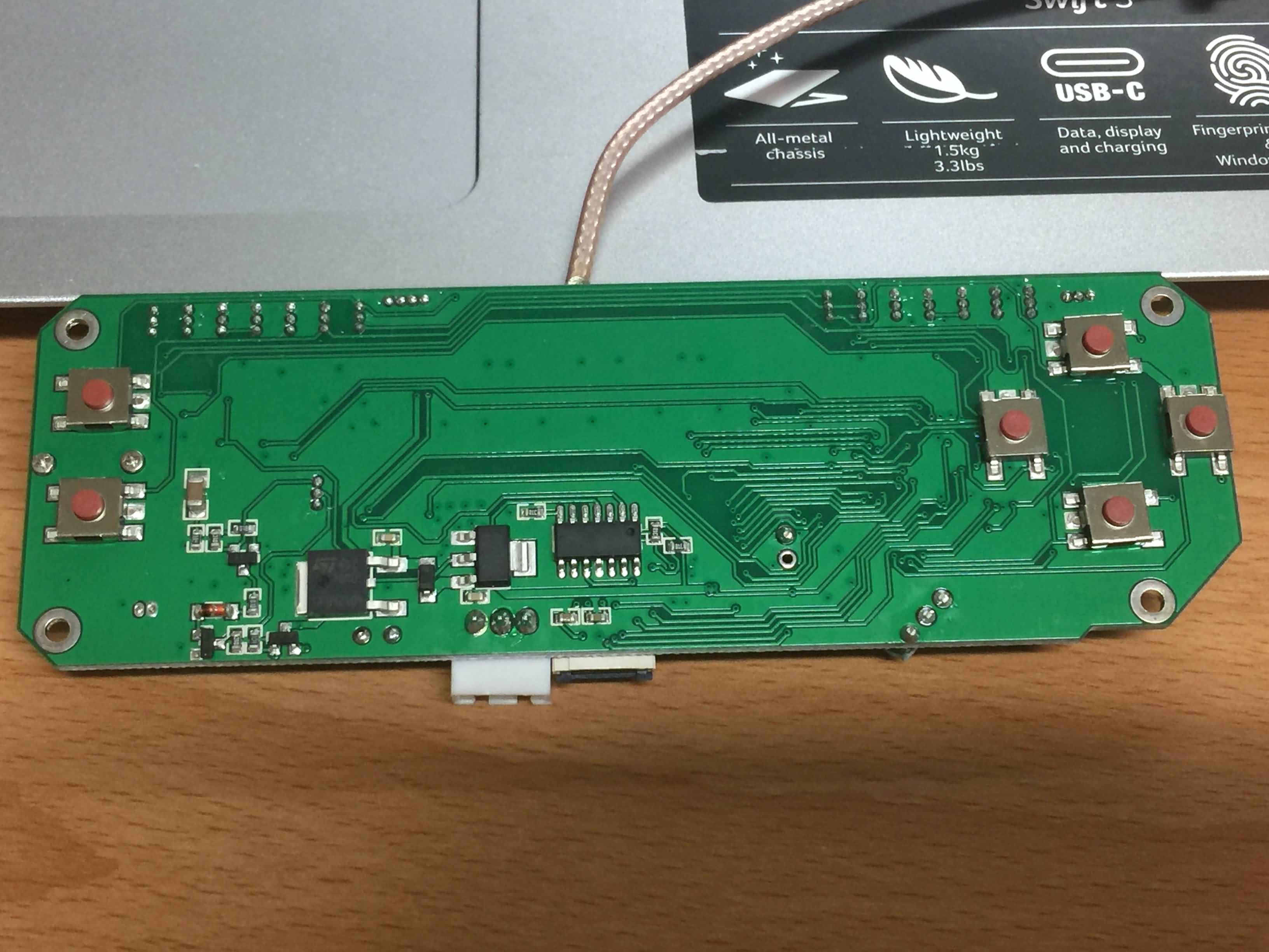

20 Sep 2017 05:56 #64531 by dc59
vlad_vy wrote: Now T8SG target doesn't contain any code, only definitions and makefile, the same approach as for devof-XMS targets.
dc59, can you test this build?
No problem,I will test it after work ! :)
This is back side of T8SB PCB picture, hope it will help for development.
