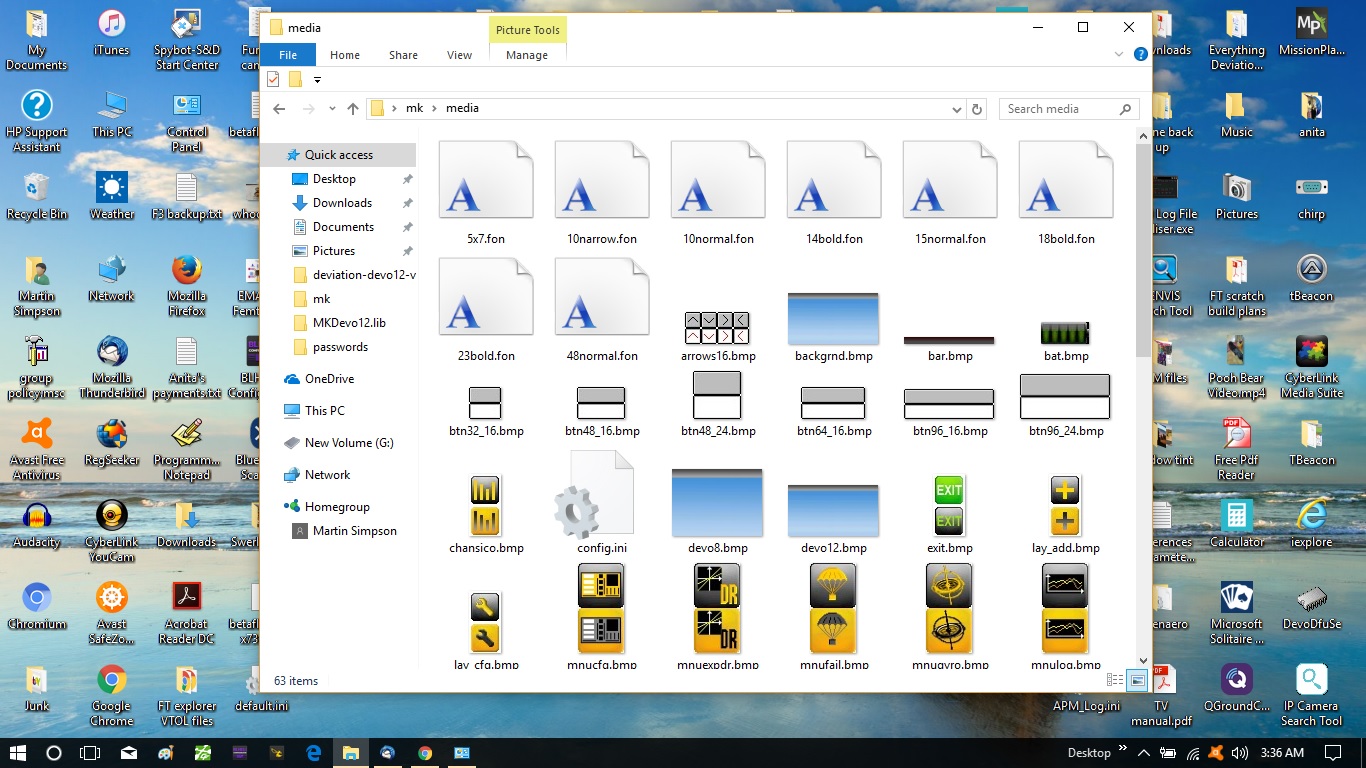

Finally figured it out...OMG the script file was in a file named script so i removed it and now it works..But now my screen is black again and i can't remember how to get the blue background back...i tried renaming the devo12 file but it wont work..Could somebody lease tell me which file i need to rename and what to name it..?
28 Mar 2017 06:29 - 28 Mar 2017 06:31 #60838 by Morlacus
magic_marty wrote: Finally figured it out...OMG the script file was in a file named script so i removed it and now it works..But now my screen is black again and i can't remember how to get the blue background back...i tried renaming the devo12 file but it wont work..Could somebody lease tell me which file i need to rename and what to name it..?
You need to have in your media directory a file named devo12.bmp just to please the programm and the blue background which was named devo12.bmp has to be renamed backgrnd.bmp. So copy devo12.bmp and rename it backgrnd.bmp

28 Mar 2017 06:58 #60839 by magic_marty
like this?
28 Mar 2017 07:06 - 28 Mar 2017 07:22 #60840 by magic_marty
Tried copy and rename the devo12 and still black backgrnd ..do i need to put the .bmp at the end of the name of the file?
Got it working i removed the .bmp from the devo12 and backgrnd files and now i have the blue background again...
Thanks for helping..

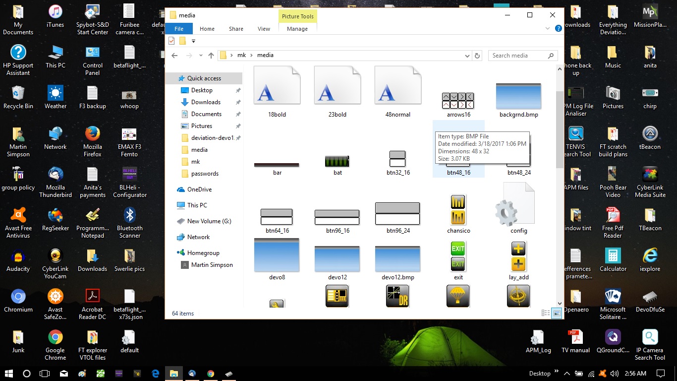

28 Mar 2017 07:29 - 28 Mar 2017 07:38 #60843 by Morlacus
magic_marty wrote: Tried copy and rename the devo12 and still black backgrnd ..do i need to put the .bmp at the end of the name of the file?
Would be simpler if you have all extensions of files appearing
So go to files options and unmark "Hide file extensions for known file type" then you should see the full name of your files" and give a new screenshot
Please to see that it works

28 Mar 2017 07:29 #60844 by magic_marty

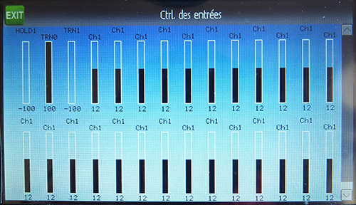

on the transmitter menu>input monitor i have 25 ch1 sliders does anybody else have this? As far as i can tell it is not causing any problems just kind of weird..

28 Mar 2017 07:37 #60846 by magic_marty
Got it...thanks

magic_marty wrote: on the transmitter menu>input monitor i have 25 ch1 sliders does anybody else have this? As far as i can tell it is not causing any problems just kind of weird..
I confirm i have the same thing
28 Mar 2017 18:28 - 28 Mar 2017 18:29 #60865 by Moeder
I can confirm your finding and while testing found another bug with the input monitor. It can be reproduced on all color screens, although it is a rather cosmetic issue, as it won't hurt functionality. I opened two issues at Github .
