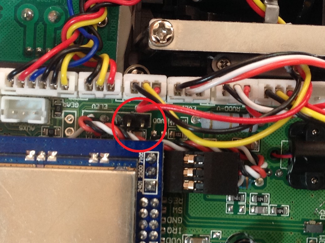

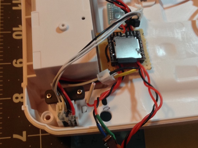

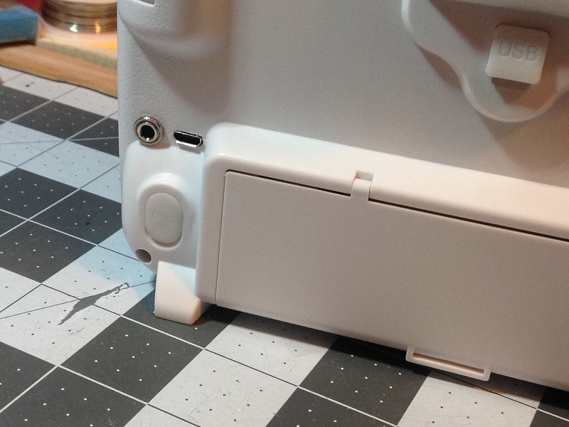

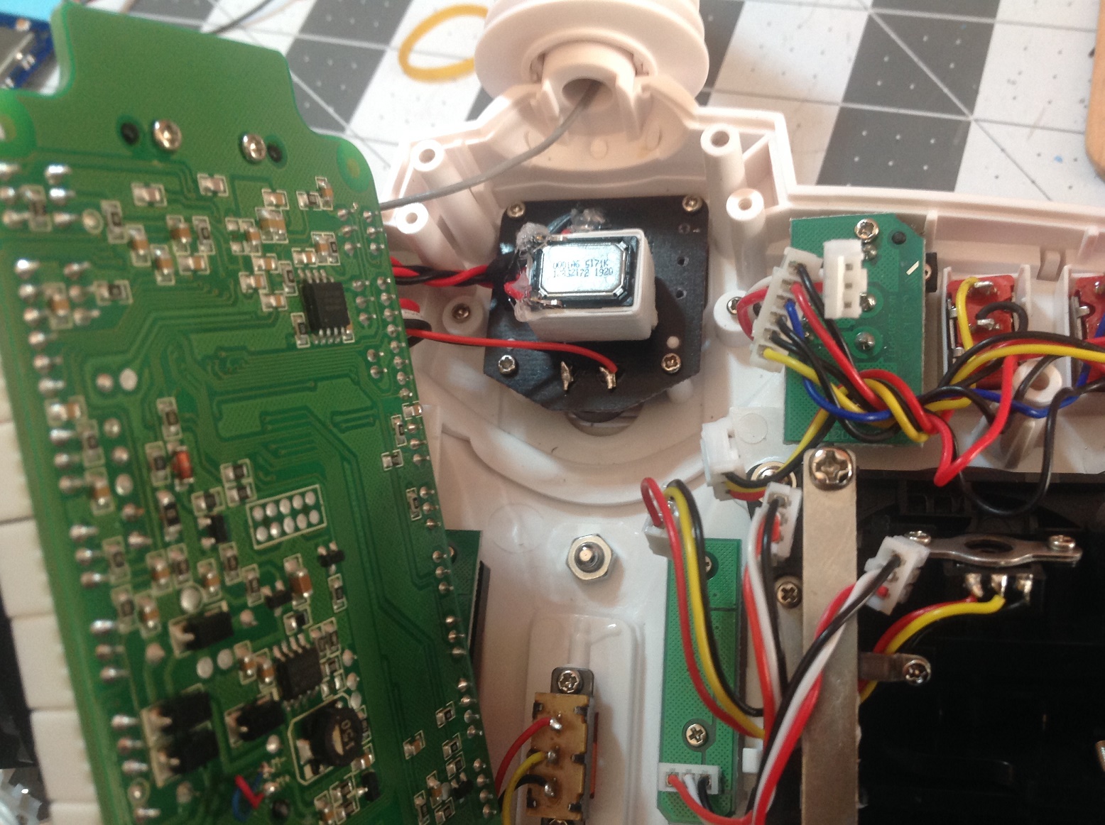

I finally finished my internal build of the DFPlayer for voice alerts in the Devo 12e. I was happy to be working in my Devo 12e because it gave me lots of space to try different placement. The solution I've come up is based on a desire to have a fully functional system that can be easily maintained within the normal system. So in addition to the ability to use the Deviation voices, I wanted to be able to edit or replace voice files without opening the TX, I wanted to be able to listen privately if needed, and I wanted to be able to use the PPM port for other purposes when appropriate. As a bonus, I also wanted to be able to see when the board was active.
The solution included these basic parts:
In post #61032 I posted the design for a micro speaker enclosure. The enclosure with speaker installed is just 15mm long x 11 mm wide x 11mm deep. After staring at the insides of my Devo I realized there is a cavity just under the antenna on the front that normally houses just the buzzer. The speaker enclosure fit nicely on the back of that board. That area has about 15mm clearance; the front has about 9mm clearance, so the enclosure would not fit on the front (I may try a new speakerbox). I mounted it with double-sided tape. I added the Blue LED to the same board and it nicely illuminates the Devention logo on the front when the voices are silent.
I struggled a bit for placement of the headphone port and USB port. Installing a USB port means I can connect to my PC and edit the SD card on the DFPlayer when I need to edit voices or other files, and it saves me from having to position the DFPlayer board to gain SD card access. While there is quite a lot of real estate in the back shell, I wanted to keep the wiring short and out of the way of any other functionality. I ended up putting them next to the Game port, and this also allowed me to easily tap the TX line. I chose to use the Switched TX line from the Game port. Under normal circumstances the switched TX line and TX line are connected, and if I insert a plug into the Game Port, the switched port is disconnected. This means I can use PPM In/Out without worrying about my voice module. Of course that also means that I cannot hear the voices when the jack is in use... which may be an issue if you are using a head tracker or perhaps a ppm-connected TX module (like the LRS). In the short term I won't have that issue, and I will deal with it when it comes up.
Once I had positioned the speaker, LED, and headphone and USB jacks, I just needed to position the DFPlayer and power regulator. Again, In the 12e there is lots of room and it's convenient to put them near the center down by the battery compartment.
The last item to connect was power. For simplicity I chose to install a header into the debug port Vcc and GND holes. In retrospect it would make sense to use something polarized, and the combined height (off the board) of the header and connectors actually touches the back shell. Not the best approach, but workable.
The end result works beautifully. Please let me know if you need more details.
- DFPlayer Mini MP3 Player
- Pololu Step Up/Step Down power supply, Pololu part S7V8A, set to 4.2v
- Speaker (Knowles 2403-260-00001, 15mm x11mm micro speaker)
- Headphone Jack (mono -- I tried a stereo jack but it didn't seem to work)
- USB Jack (I chose a Micro USB female)
- Indicator LED (I figured Blue to match my sticks!)
- plenty of 30 gauge wire and Micro JST 2.0 PH 2-Pin Connector, M/F pairs
