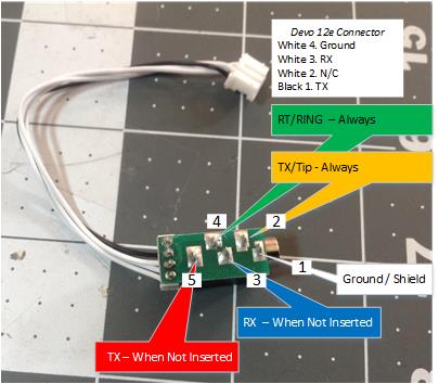

The Devo 12e has a different jack than the Devo 6s/7e/8s/10 and the wiring is not the same. In this connector, which bears the part number "WK2801-JACK2", there isn't a mechanism to short the RX pin to ground.
Both the TX and RX pins are always connected to Tip and Ring respectively with or without the plug inserted. The jack has one additional pin for each of them that is connected when the plug is not inserted. So it is possible to wire the TX line to the DFPlayer on pin 2 so that it is always connected (with the possible effect that whatever is connected by the plug may introduce problems). You could also wire it to pin 5 so that the TX line connects to the DFPlayer only when the jack is not in use.
I checked the FCC photos for the F12E and it looks like it's wired the other way. Is the Devo 12 wired like this one?

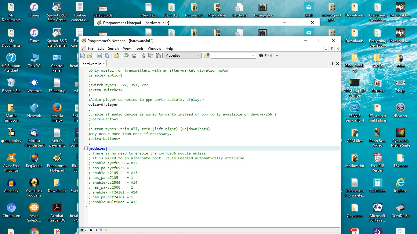

26 Mar 2017 08:46 - 26 Mar 2017 08:50 #60758
by magic_marty
Here's a screen shot of my hardware.ini seems to be fine ...
Last edit: 26 Mar 2017 08:50 by magic_marty. Reason: wrong pic
26 Mar 2017 09:09 #60760
Yes, it seems, but you need to switch on showing the hidden characters to be sure.
Use the fifth Pi like buton at the bottom...

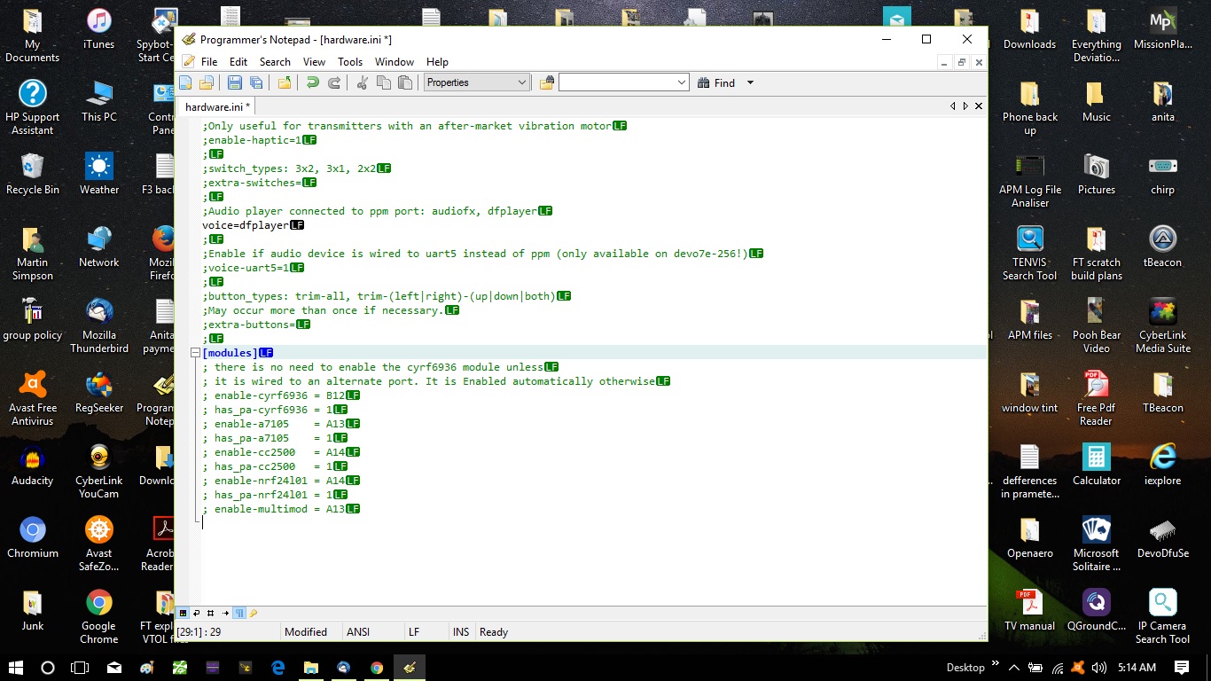

- magic_marty
- Posts: 706
26 Mar 2017 09:16 #60761
by magic_marty
like this?
26 Mar 2017 10:06 #60764
Yes, now we can be sure that the file is fine.
