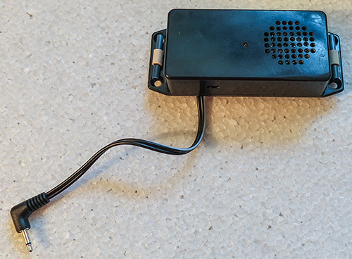

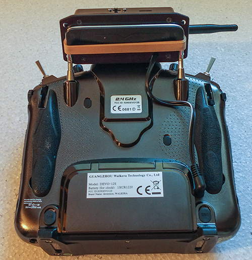

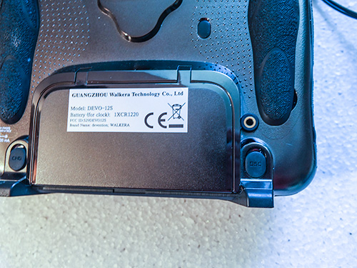

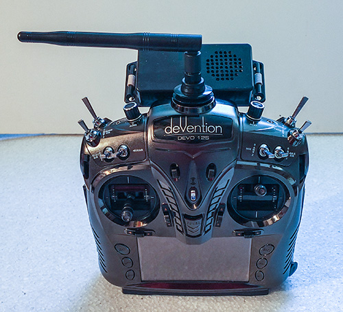

Some snapshots of my soud box and how it is strapped by a rubber band on the handle of my devo 12s (exactly same as for my devo 8s) On the 12s I put a female jack linked to the pins TX and Ground.
The speaker is in front of me and I have a very good sound. I can also use an earphone.
