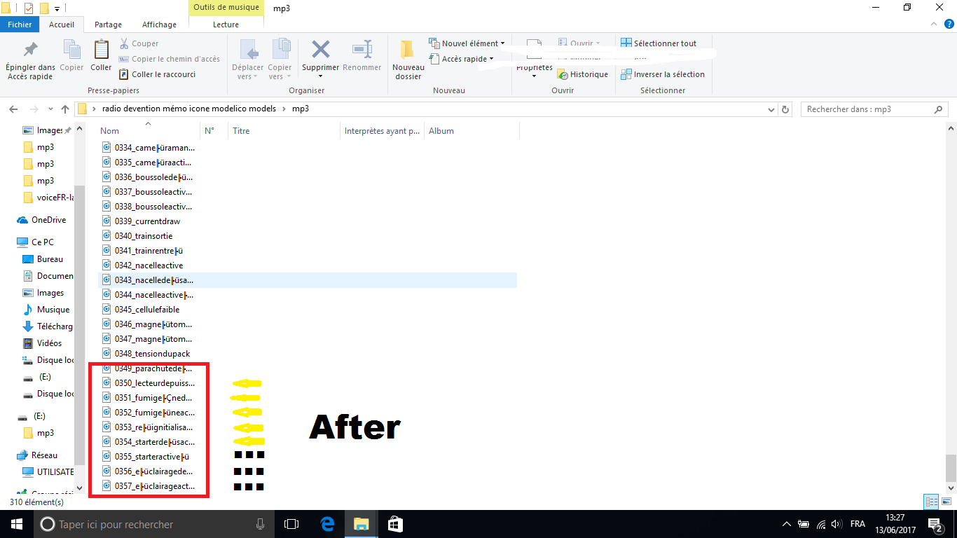

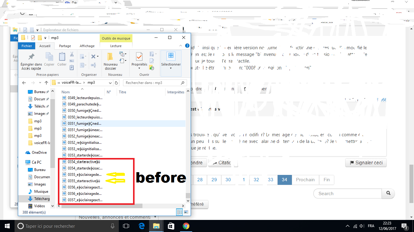

Hello Moeder
Here is my modified mp3 file because ads do not work or do not match their writing.
Another problem is that telemetry alerts (volt) are read in units; That is to say 10,5V is announced 1,05V ....

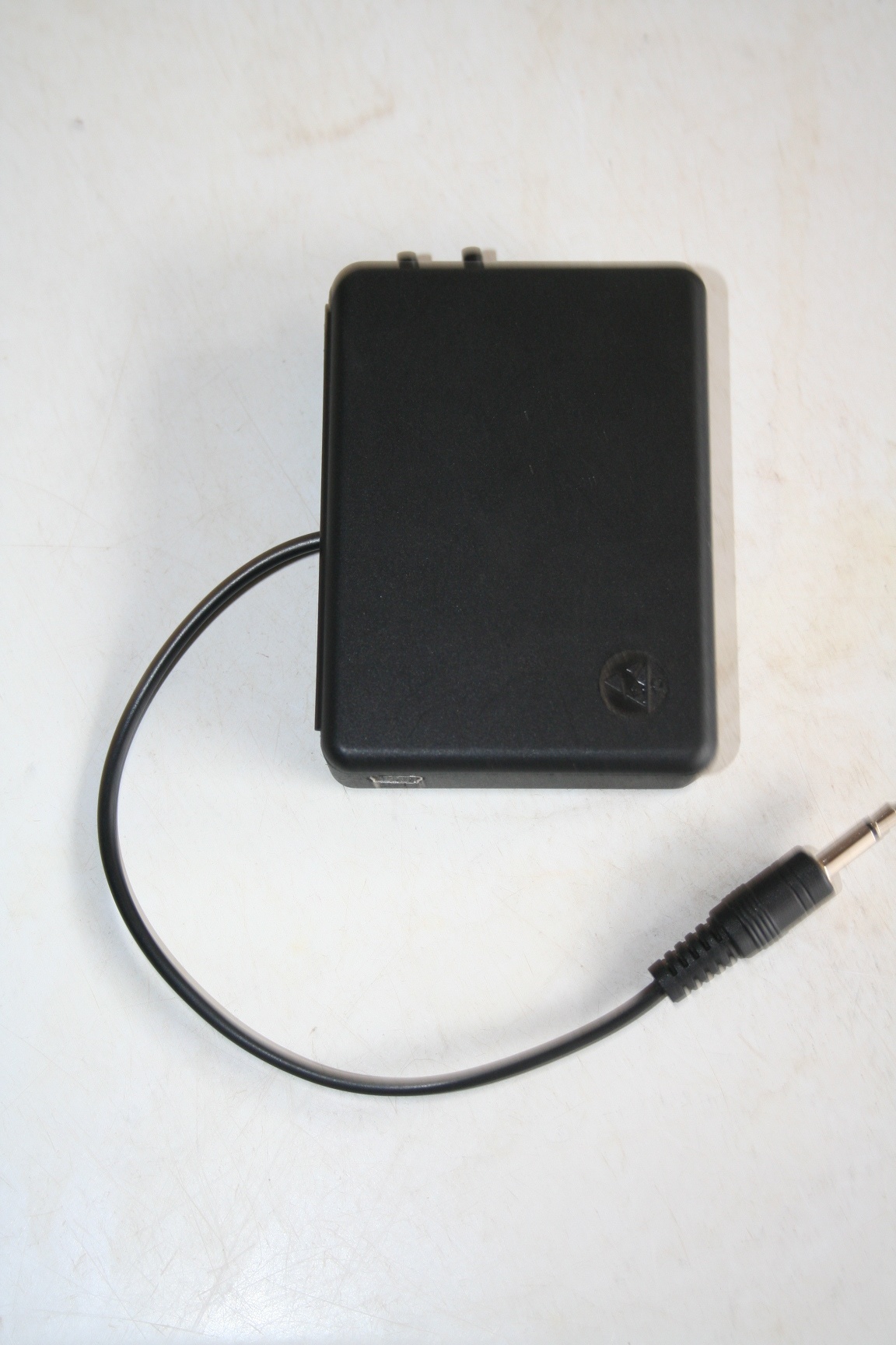

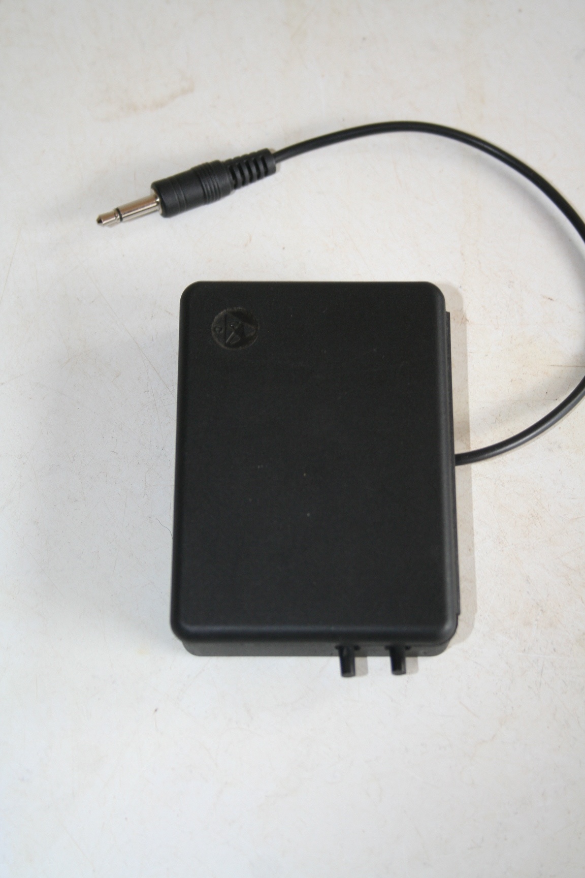

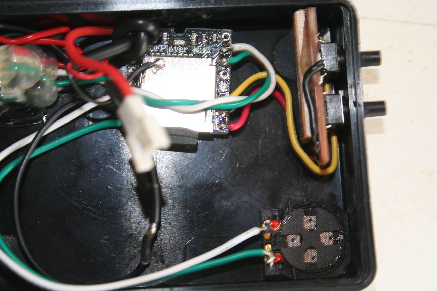

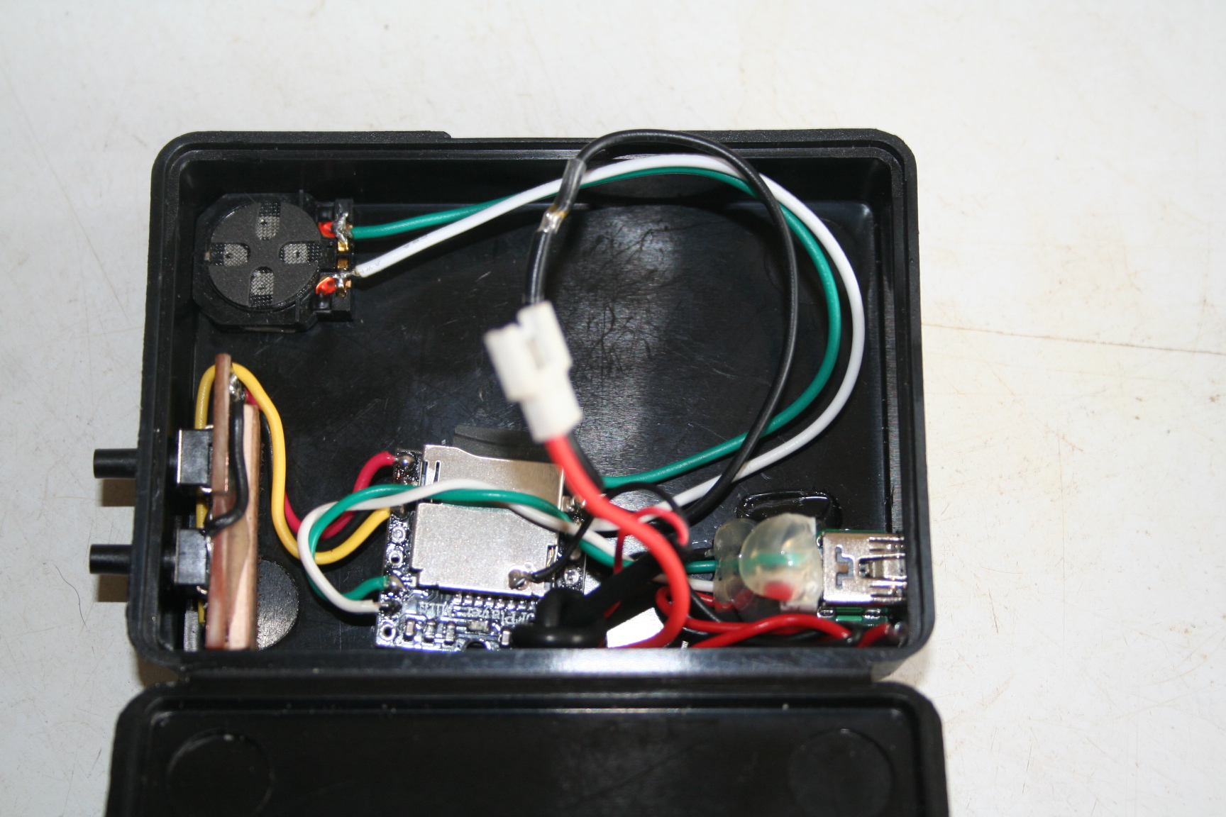

Thanks to all involved in voice alerts builds, you have piqued my interest to make this for my devos,
This is my external test voice module.
I used this speaker from BG www.banggood.com/Loud-Buzzer-Ringer-Spea...G900V-p-1033038.html
The speaker is very small but seems to be loud and clear enough. Video with sound on youtube
From the usb socket I have hooked up the green & white wires to usb+ & usb- on the DFPlayer but this doesn't seem to work, do I need to connect the power or ground for usb to work?
Edit. I found the answer on page 4 of this thread, hooked up the ground to the usb socket and all works.
