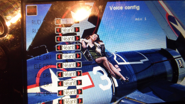

I have a devo 12s with the module dfplayer with voice.fr; It works, the sound is strong but I do not have all the alerts (it stops at 9 (mix)) ???
Does anyone have a solution?
Goodbye also does not work, however, chronos, welcome, inactivity alarm work.
I'm in devo12-5.0.0-58e29b0
Thank you

Bonjour!
The French voice set ist still the limited pack made during development and only contains nine custom alerts. If you want, please download the voice-en-large.zip, translate all English descriptions and pm it to me or post it here. I can the quickly generate the large set in French and upload it to the downloads section.
Concerning goodbye message, it is a known bug.)
