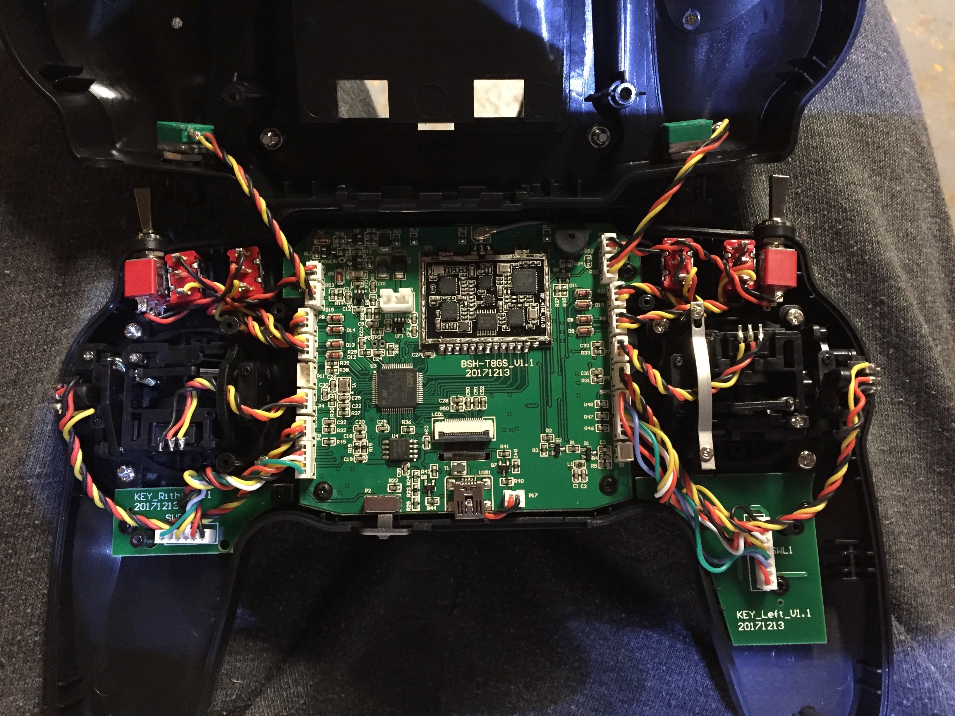

It looks like iRX-IR8M has four 3-pos switches and two shoulder 2-pos switches:
I need confirmation from Mitchie.
As usual things messed: all switches reversed, AUX4 and AUX5 reversed, stick directions the same as for devo7e-256, batt_critical need to be 3900, since iRX-IR8M can work with 4xAA battery.
Last edit: 20 Jan 2018 08:55 by vlad_vy.

Replied by vlad_vy on topic iRangeX iRX-IR8M 2.4G 8CH Multi-Protocol
I suspect that iRangeX use "hardware.ini" from T8SG without modification, so "H" and "G" shoulder switches are undefined.

23 Jan 2018 05:40 #67059
Changing "hardware.ini" doesn't help enable shoulder switches. From mainboard images it looks like they connected to AUX4 and AUX5 pots. I don't know why they needed.

23 Jan 2018 16:21 - 23 Jan 2018 16:30 #67077
Are you sure? On the mainboard image I definitely see connections and diodes for four 3-pos switches and connections for two 2-pos switches. The original "hardware.ini" enabled four 3-pos switches and two pots (AUX4 and AUX5).
extra-switches = 3x4
extra-switches = potx2
It looks like shoulder switches connected to AUX4 and AUX5 lines. So they havn't names. I don't know for what they used.
