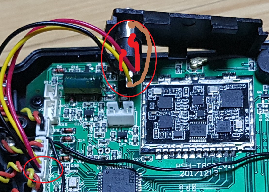

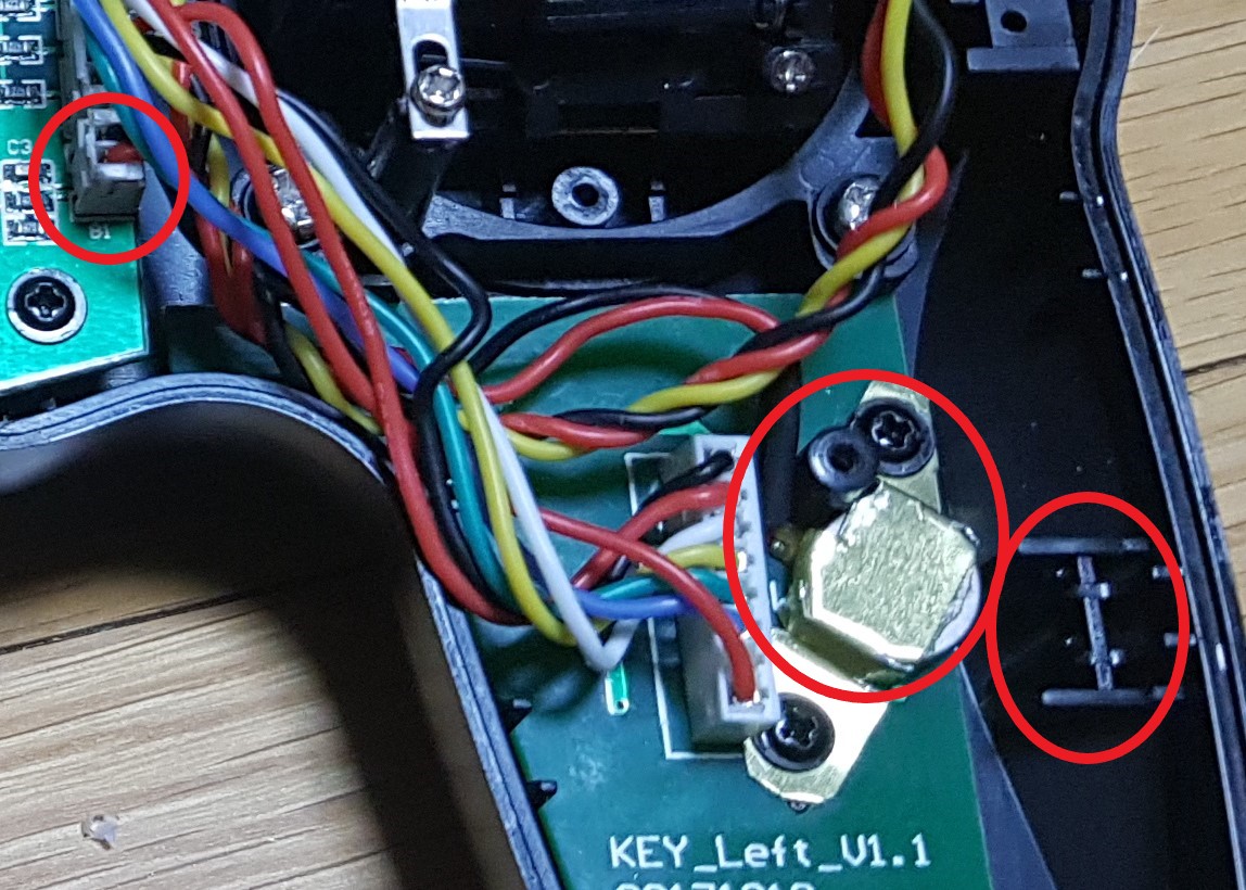

10 Mar 2018 10:23 #67994
by wdlee
Replied by wdlee on topic iRangeX iRX-IR8M 2.4G 8CH Multi-Protocol
Hi.
I connected the trainer port and tried to connect the vibration motor.
Fortunately, it was successful.
This unit has a universal vibration motor hole. But I had to make a separate case to connect the remaining motor.
I can not understand why these things were not installed from the beginning
I can not trust this device.
