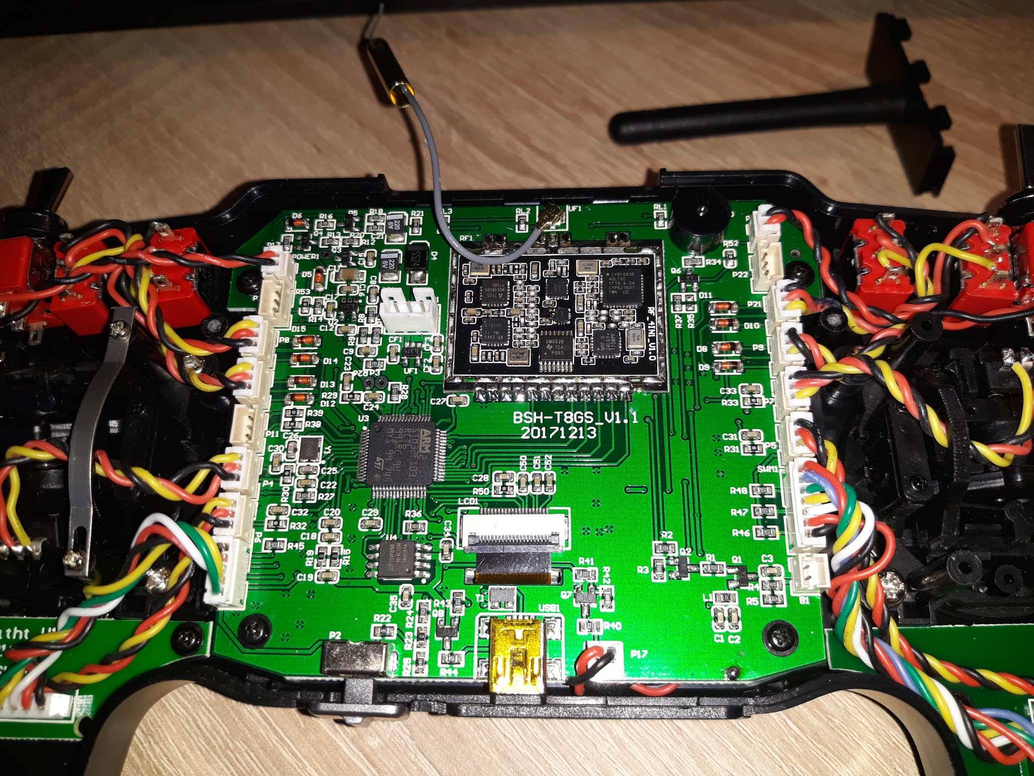

So one says it is exactly the same, the other says it has no firmware.
As far as I know all 3/4-IN-1 modules have/had firmware and I'm pretty sure the IR4X has an STM32.

what is the same is the module itself but as you have been told what controls the firmware of the module is the deviation firmware

4in1 module has not MCU and firmware. It can be used with additional board with MCU and firmware, such as DIY Multiprotocol TX Module with firmware.

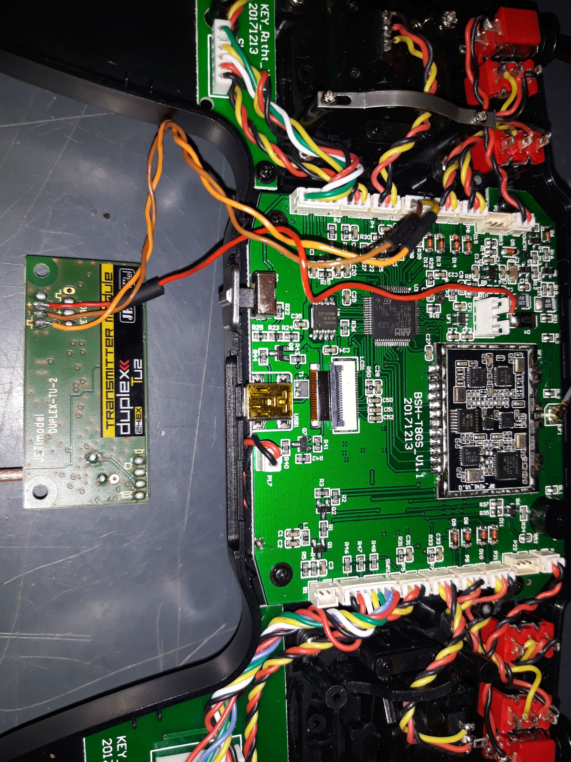

P11 connector. See page #8.

Black - PPM ?
Red - GND ?
Red - GND ?
10 May 2018 03:49 - 10 May 2018 03:51 #69153
Replied by vlad_vy on topic iRangeX iRX-IR8M 2.4G 8CH Multi-Protocol
I don't know. I havn't IR8M.
I think P11 central pin is GND and outer pins are PPM in and PPM out.
Last edit: 10 May 2018 03:51 by vlad_vy.

You need select PPM protocol for your model in order get PPM out.
Habasek wrote: GND I measured on a black pin in P11 (down), in the middle is 3.3V and there is no voltage on the yellow pin (top).
But PPM does not go to the second module either from the middle or from the top pin.

I figured out my misconception regarding the "module" and its firmware, after inspecting said "module". The actual RF board indeed has no firmware, it just uses CS lines and the board the "module" comes with runs the STM32 with firmware.
Once I get it swapped out and do some testing with it over the coming days, I'll report back if it fixed the dropouts.
