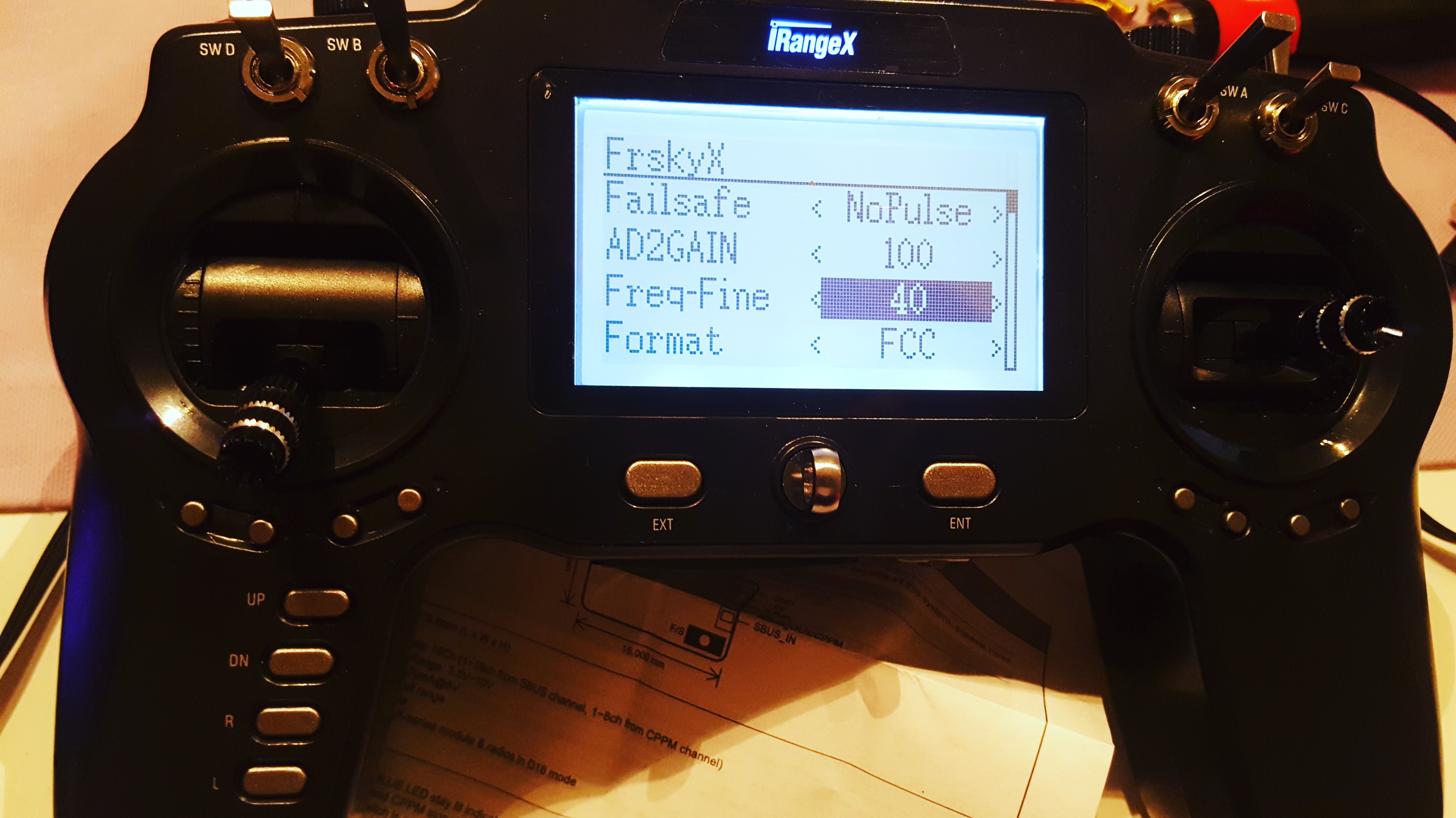

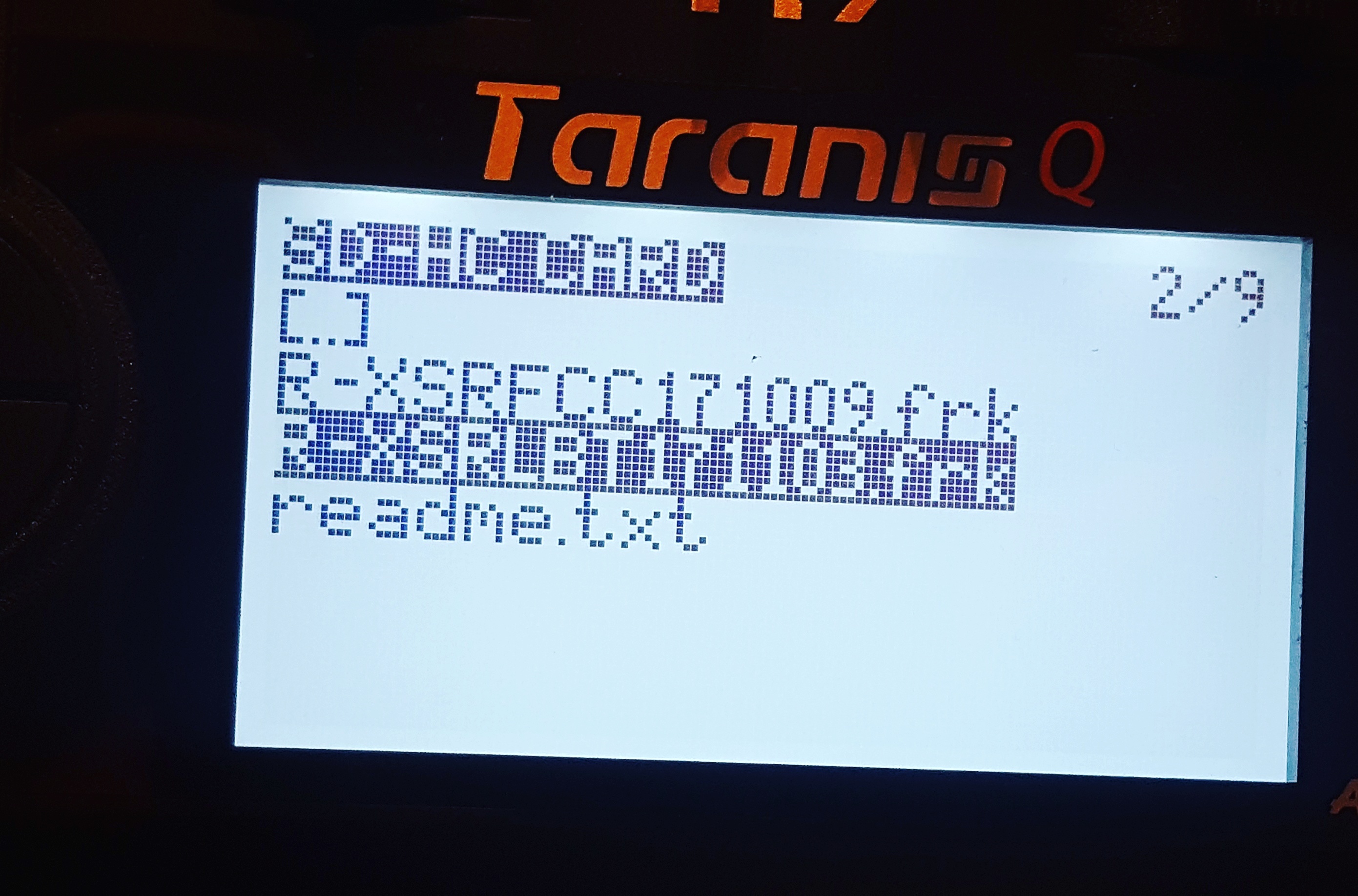

26 Jan 2018 05:00 #67171 by antennenfreund
Replied by antennenfreund on topic iRangeX iRX-IR8M builds
To run the remote control with the new receiver you need a specific software for the receiver. Not every version works. It is very important to set the value to 40-41 as in the photo.

26 Jan 2018 06:58 #67176 by antennenfreund
Replied by antennenfreund on topic iRangeX iRX-IR8M 2.4G 8CH Multi-Protocol
Is Freq-Fine 40-41????

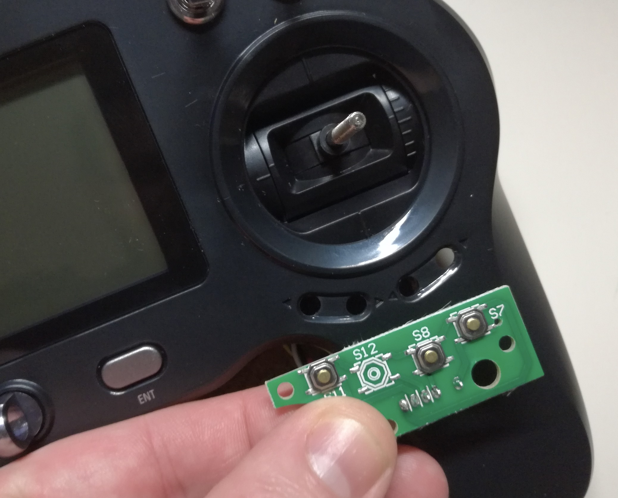

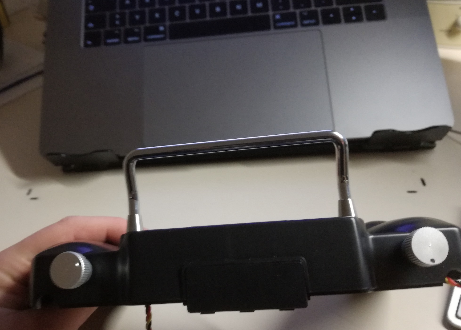

26 Jan 2018 16:26 #67199 by Theta2
Replied by Theta2 on topic iRangeX iRX-IR8M 2.4G 8CH Multi-Protocol
I've got my one today from banggood and i'm really disappointed, because of a missing button.
When i checked out all of the buttons i missed the click-sound when i pushed down the button S12 (trim backwards).
I've decided to open the radio and i was really really disappointed about what i found, see the attachment.
The second thing is, also attached, that the wheels on top have a totally different zero point. I can fix this, but the button is still missing afterwards.
I'm asking myself, how can someone forget to solder a button on the circuit board. To they not have a quality assurance what will push each button at least one time?
And, the wheels are not the one displayed on all product pages? They show chrome wheels of stainless steel or chromatted wheels what i got are wheels of white steel. So they attract me with a higher quality than i will get. All in all this this makes me feeling like i got ripped off. Thats not a good way to create long term customer relations. It's far away from that.
Did someone else have the same problem with the irangex irx-ir8m? a missing s12 button on the board?
26 Jan 2018 17:32 #67200 by SeByDocKy
Replied by SeByDocKy on topic iRangeX iRX-IR8M 2.4G 8CH Multi-Protocol
Theta2 wrote: I've got my one today from banggood and i'm really disappointed, because of a missing button.
back luck for the missing DIP :( :( ... In the worst can can take one from the throttle ?
For the POT. you can take the allen key to re-install correctly the button ?

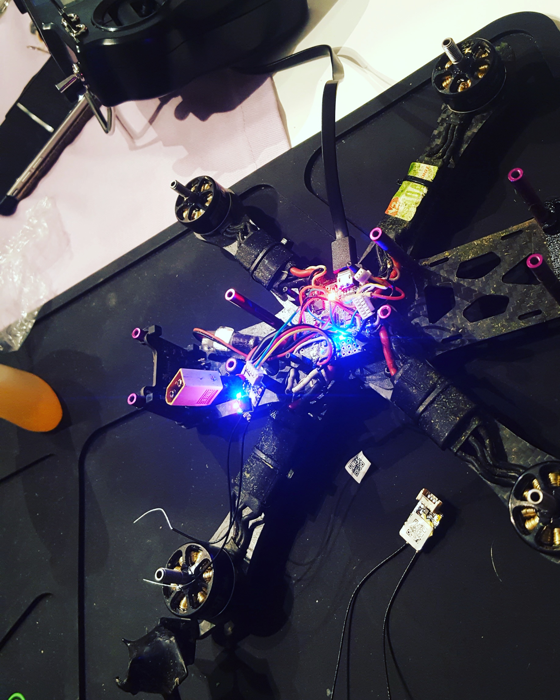

27 Jan 2018 18:52 - 27 Jan 2018 18:53 #67217 by antennenfreund
The range is VERY VERY BAD with me!
Fuck!

28 Jan 2018 11:30 - 28 Jan 2018 11:31 #67230 by antennenfreund
SeByDocKy wrote: Did you select 100mW ?
No, I also fly to 150 mw, like my friend. He also has this remote condition I have the R-xsr receiver in it .. He has the Flysky i6b.
He has no ranges problems .. I do. :(
I did that too!
