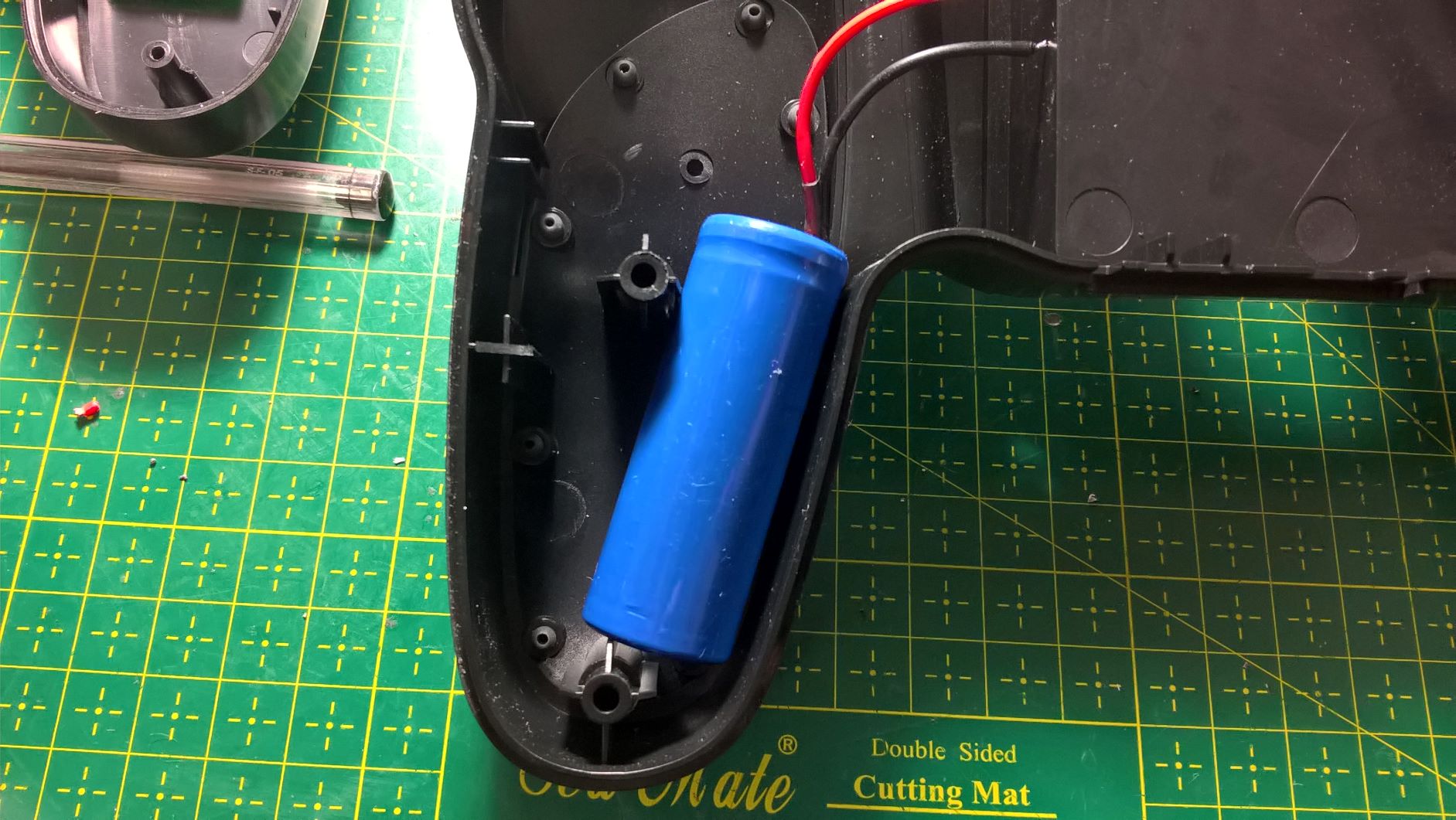

- GabrielRB
- Posts: 11
18 Aug 2018 16:36 #70329
by GabrielRB
Replied by GabrielRB on topic IR8M battery mod

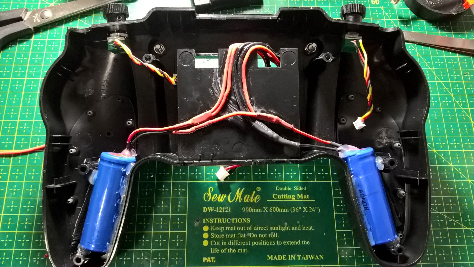

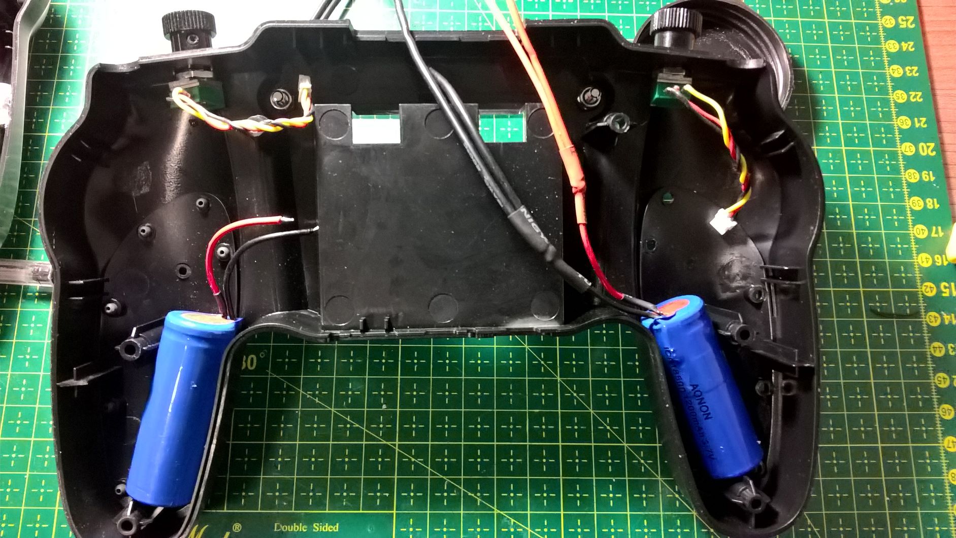

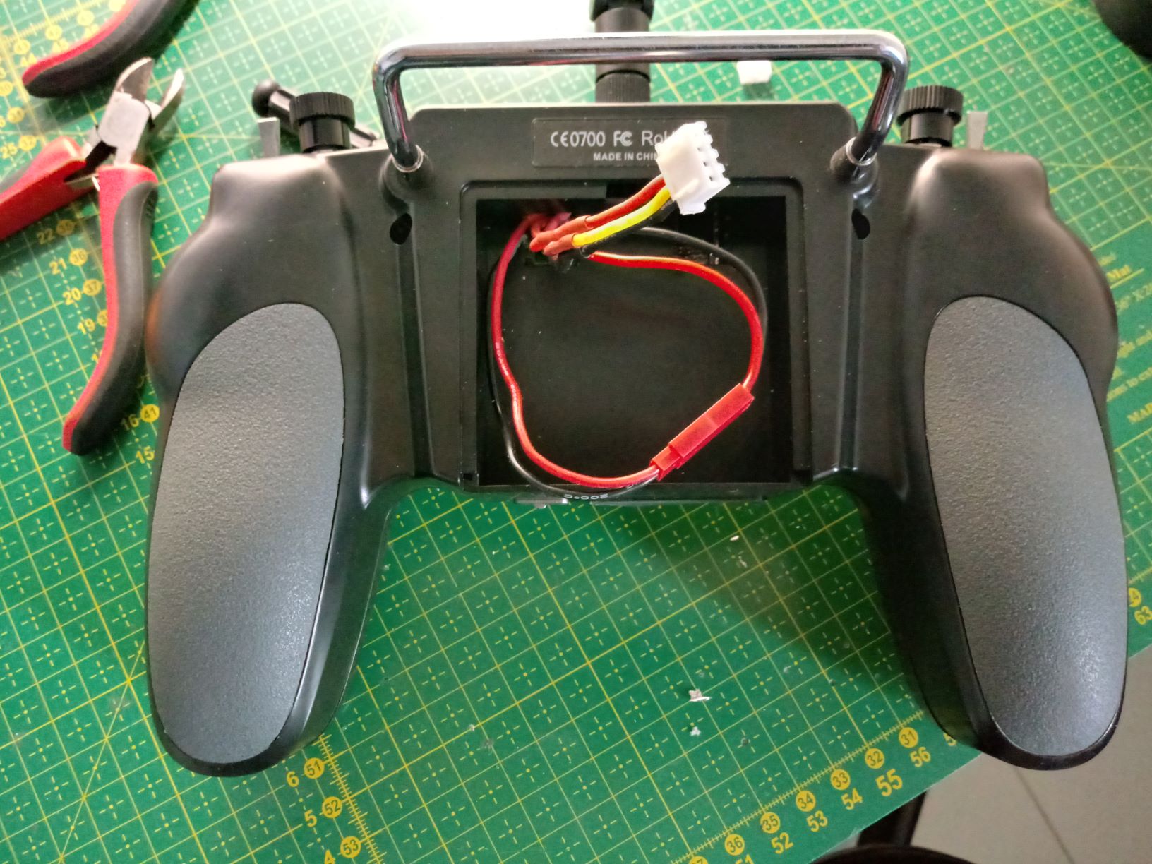

So, I decided make some upgrade on the battery of my IR8M.
I bought two Li-ion battery LCR18500 with 1100mAh (you can find others with more capacity) and installed inside the radio. Also I removed the current conector and change for a JST in order to make more easy to charge.
Very simple mod very usefull, now I have space on the battery deck to put a external module

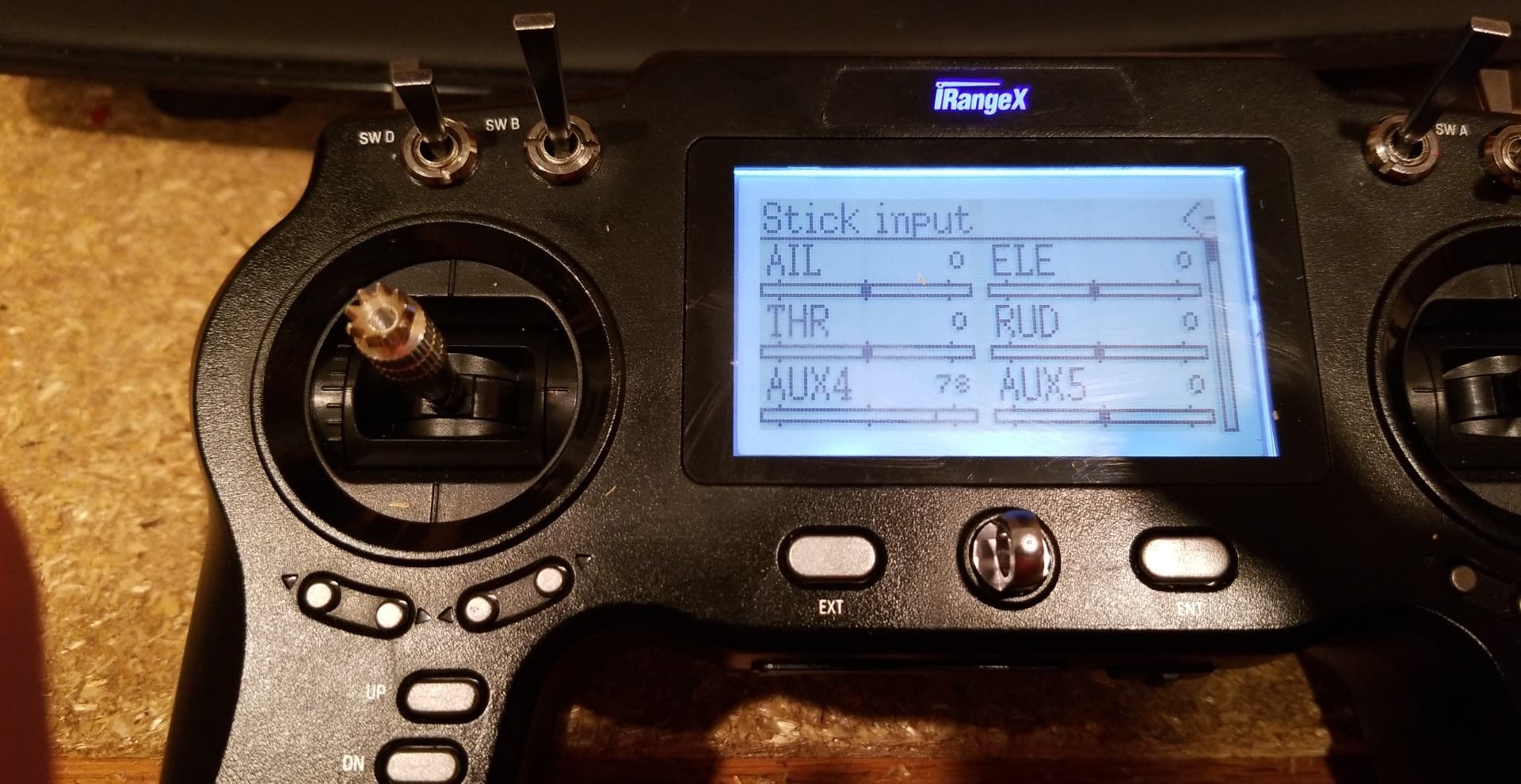

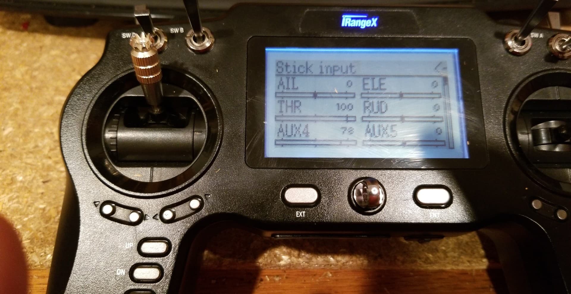

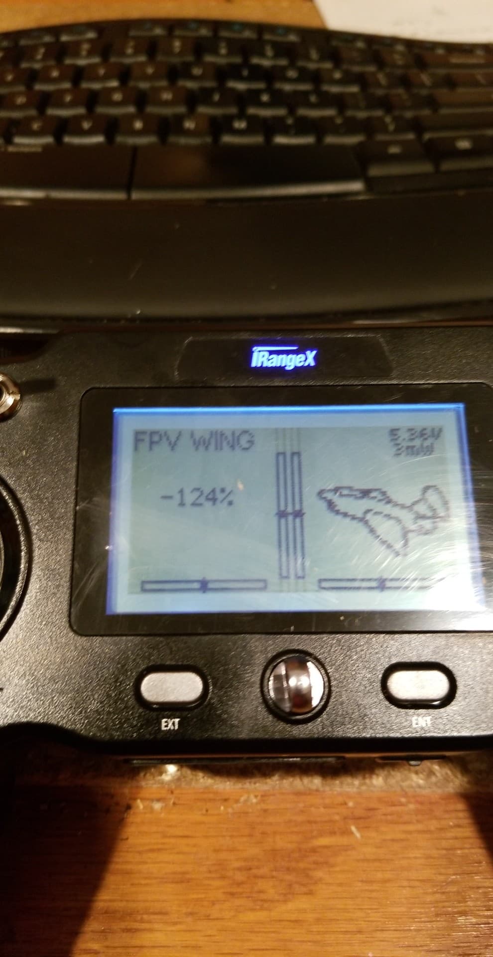

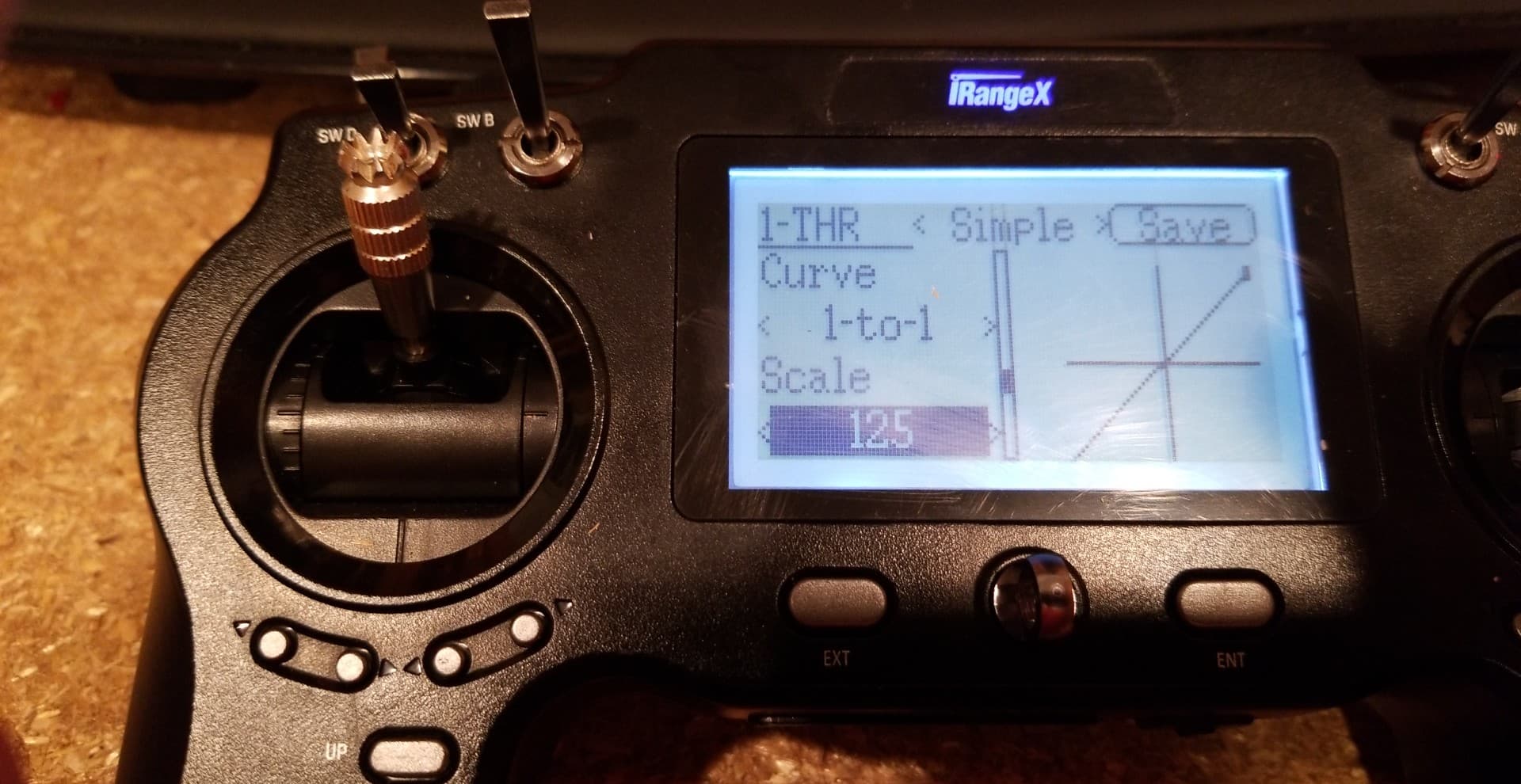

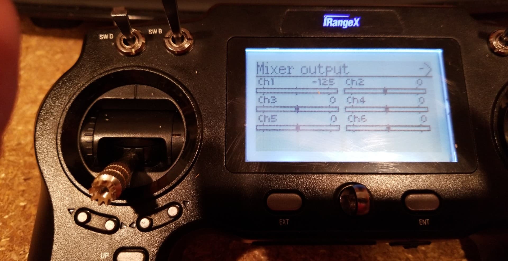

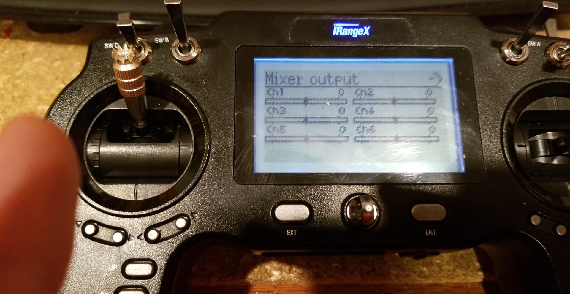

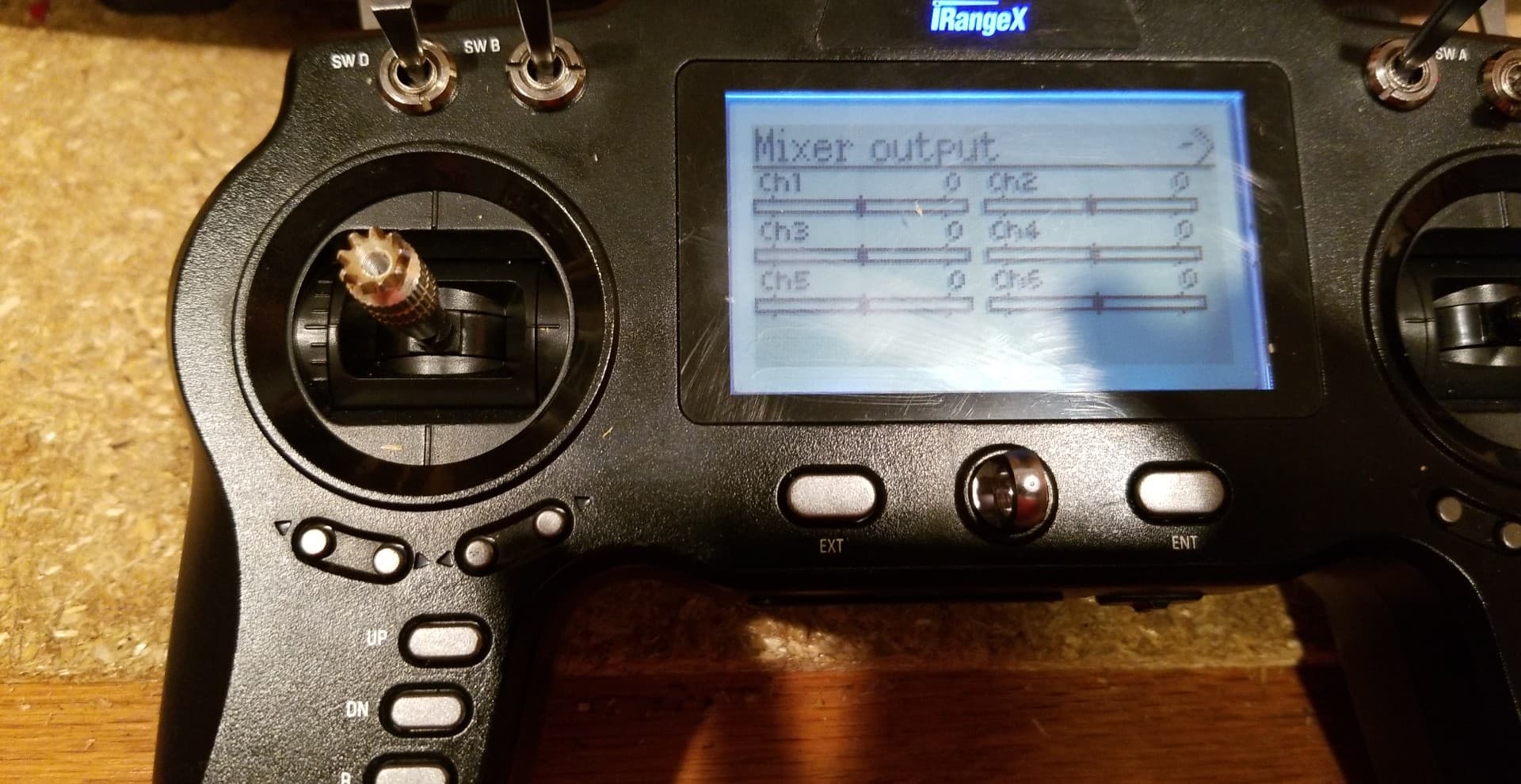

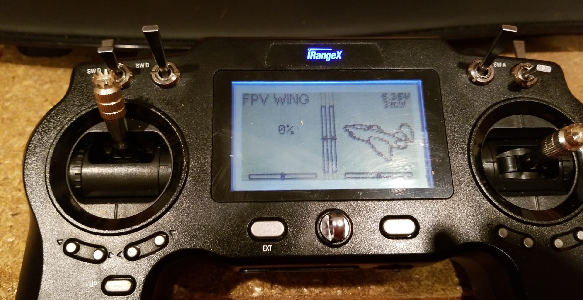

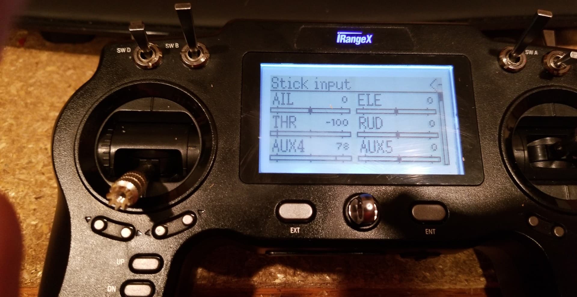

I'm having a major issue with my throttle, and can't find the answer anywhere. Just set this TX up today, updated to the latest nightly build. My issue is that the channel output for the throttle doesn't go above 0%. There is throttle response down to -125%, but above mid-stick, I'm not getting any more throttle, which means I can't fly.
I have the V2, and I'm setting this up for Plane. I don't think I have a bad sensor on the gimbal, i get a full -100/+100 when I look in the stick input menu under channel monitor.
