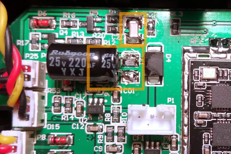

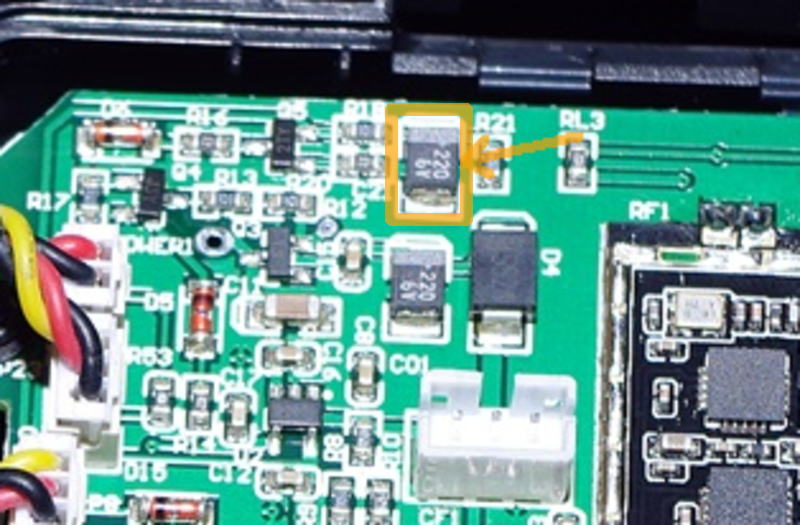

betoinbeta wrote: Transmitter powering up problem
If I turn off the transmitter I can’t turn it back on.
I tried unplugging the AA battery module and it often times still doesn’t power up.
At first I thought I had a bad batch of batteries but it still does it even with a fresh batch.
Sometimes waiting for more than few minutes does power it back up.
Does anyone else have this issue and possible fix?
It can be fixed by changing capacitor 220uF to 22uF, will be better to use 16-25V capacitors. You have to use 2 soldering irons to remove SMD capacitor.
www.rcgroups.com/forums/showpost.php?p=39085000&postcount=474

31 Jan 2018 04:08 #67299 by Hayataro
Replied by Hayataro on topic iRangeX iRX-IR8M 2.4G 8CH Multi-Protocol
Use 22uF/16V or 22uF/25V capacitor for upper cap.
And use 220uF (or less 100uF should be okay) 25V capacitor for lower cap.
Note that lower smt electrode is MINUS-Polarity.

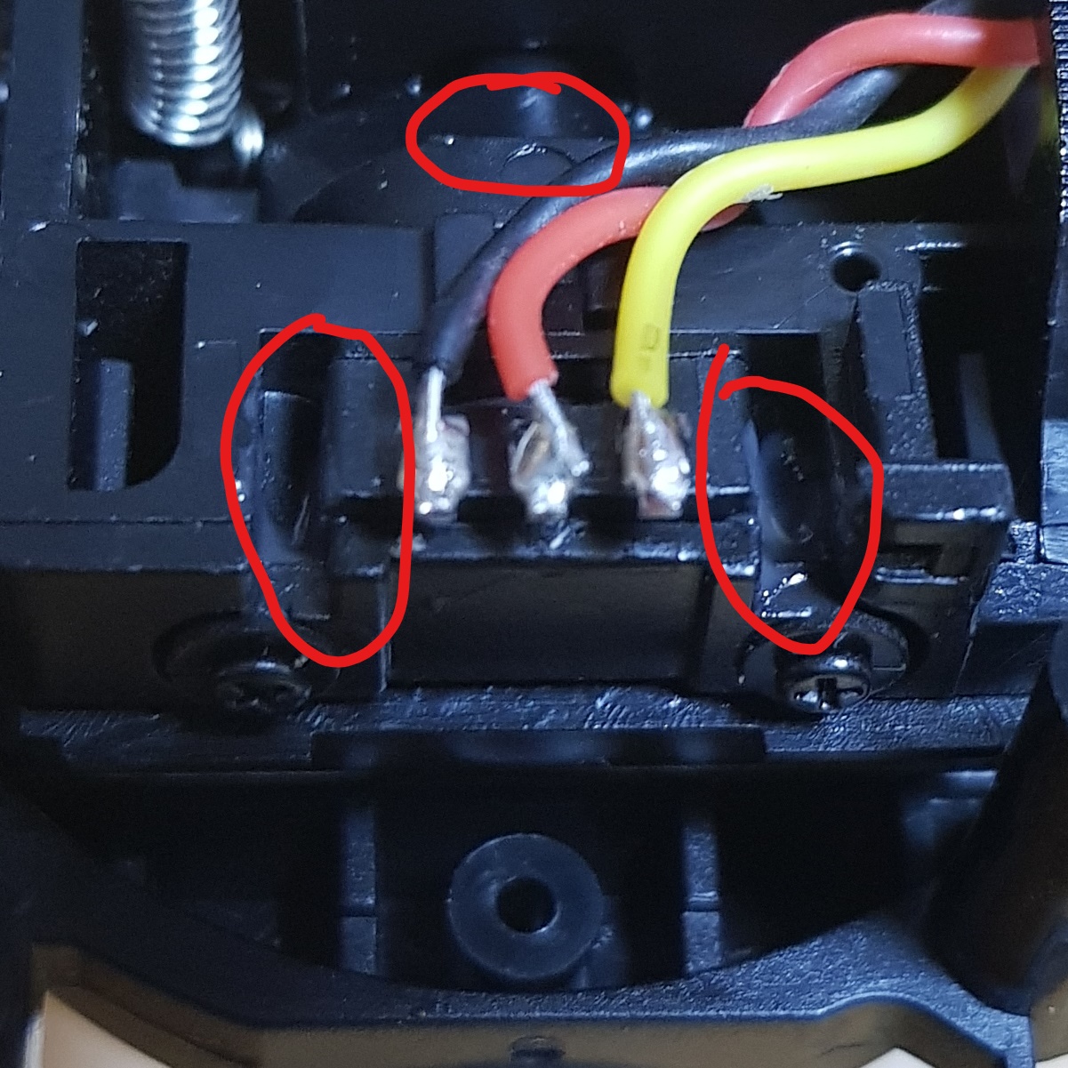

04 Feb 2018 06:04 - 04 Feb 2018 08:04 #67381 by wdlee
Replied by wdlee on topic iRangeX iRX-IR8M 2.4G 8CH Multi-Protocol
The potentiometer of Jimbol was fixed with epoxy resin.
Then the center problem was solved.

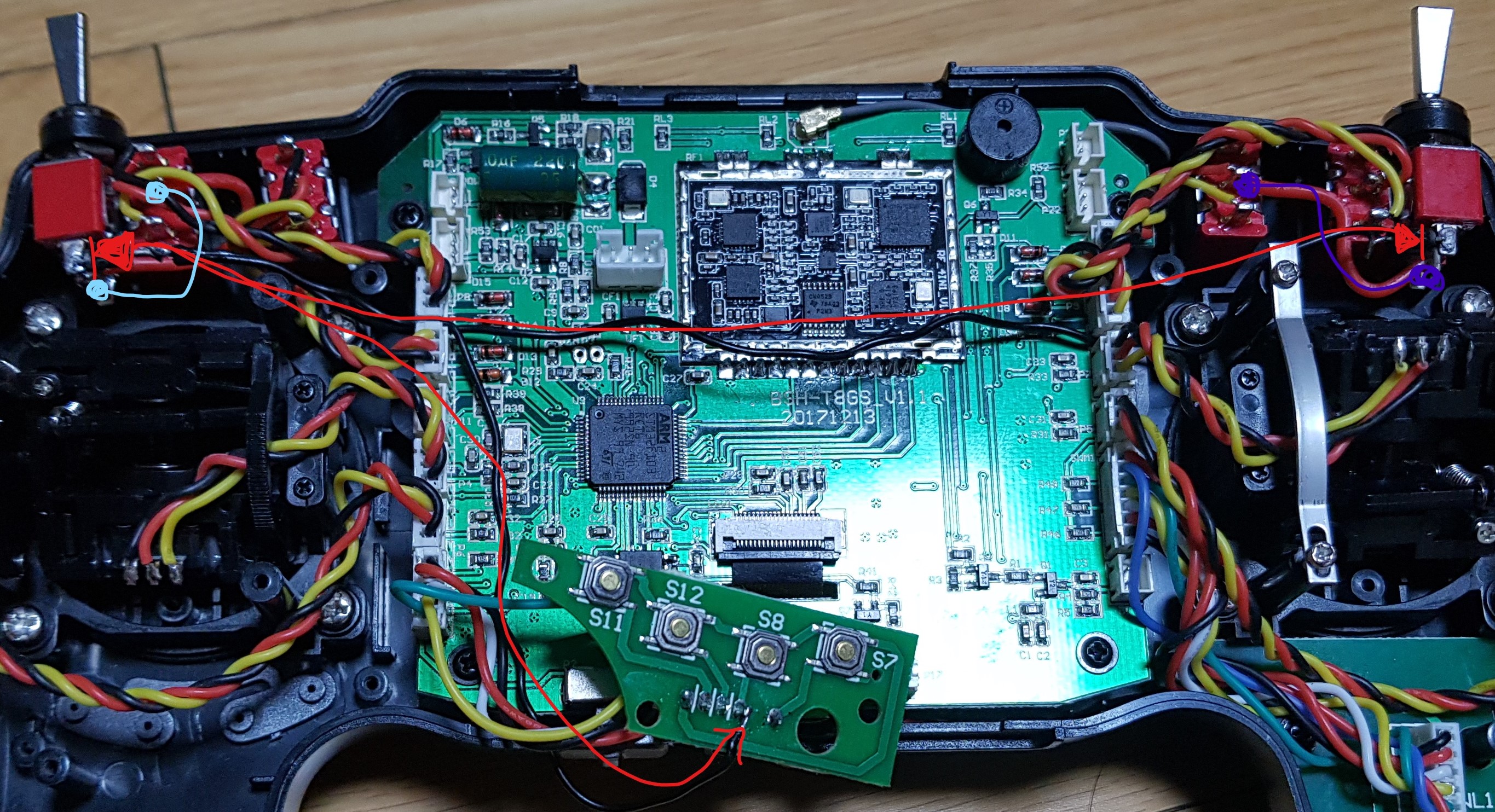

05 Feb 2018 12:49 #67402 by wdlee
H, G switch Modify photos attached.

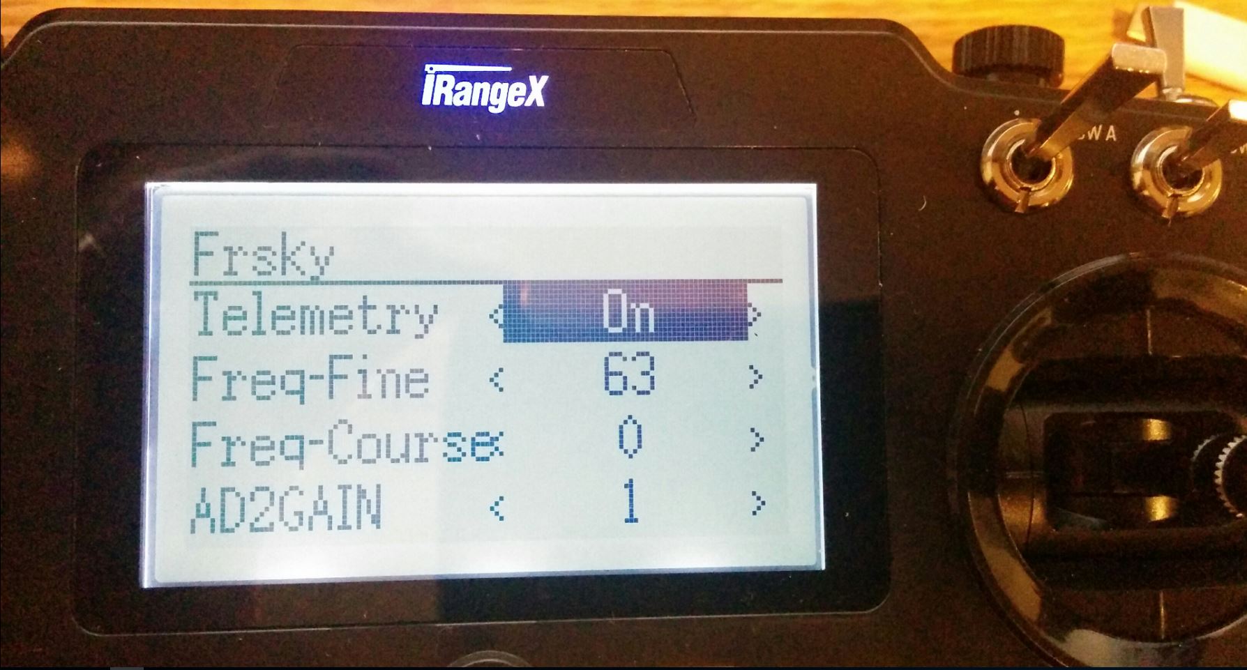

06 Feb 2018 06:06 #67412 by SeByDocKy
Replied by SeByDocKy on topic iRangeX iRX-IR8M 2.4G 8CH Multi-Protocol
For my IR8M, all FrSkyX D16 receiver needed a Freqfine set to 63... So I guess it will be requiered also for the D8 protocol

06 Feb 2018 18:28 #67423 by SeByDocKy
Yes +63
06 Feb 2018 23:24 #67424 by plmask
Replied by plmask on topic iRangeX iRX-IR8M 2.4G 8CH Multi-Protocol
Adjusting the fine frequency by 63 worked for binding the Frsky D8 receiver. Thank you.
