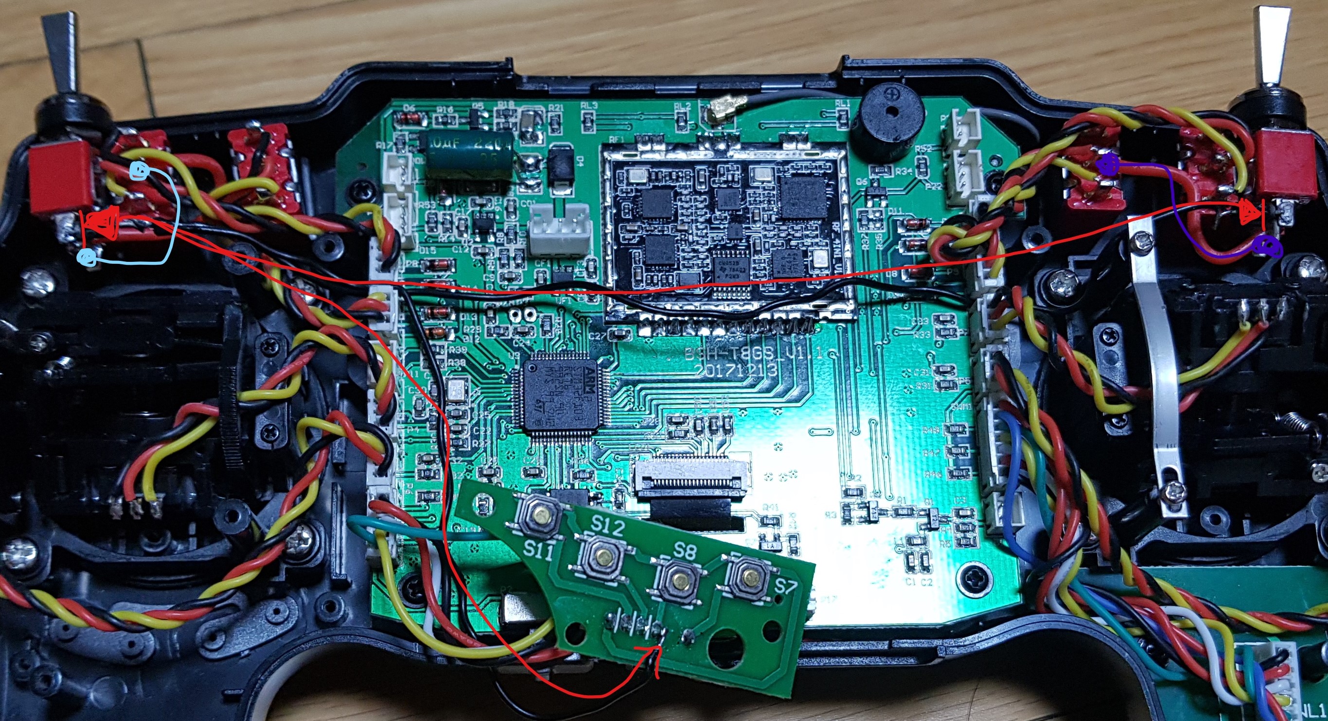

16 Feb 2018 03:53 - 16 Feb 2018 03:54 #67527 by vlad_vy
Replied by vlad_vy on topic iRangeX iRX-IR8M 2.4G 8CH Multi-Protocol
You can replace switches "C" and "D" to 3-pos switches without any mod.
You can fix power Off/On problem by changing capacitor:
www.deviationtx.com/forum/6-general-disc...tocol?start=80#67296
You can get normal shoulder switches "G" and "H" (initially they connected to AUX knobs and havn't names) by simple mod:
www.deviationtx.com/forum/6-general-disc...tocol?start=60#67227
Yes, will be better to flash latest firmware.

16 Feb 2018 22:44 - 16 Feb 2018 23:30 #67546 by Hayataro
Replied by Hayataro on topic iRangeX iRX-IR8M 2.4G 8CH Multi-Protocol
Hi vlad_vy-san, :)
I tried a mod about switch G,H but not worked. Maybe I had some mistakes.
Please inform me more in detail?
T8SG and iR8M is quite differ , so I could not understand wireings.
It's will great help if you can show simple diagram/schematic of this mod.
I'll take pics and upload how to mod description to RCG and here.
using same ID in RCGroups.

19 Feb 2018 15:39 - 19 Feb 2018 15:45 #67590 by vlad_vy
Hayataro wrote: Hi vlad_vy-san, :)
See the image from above post. But for me, I would connect diodes to other outer switch pin.
