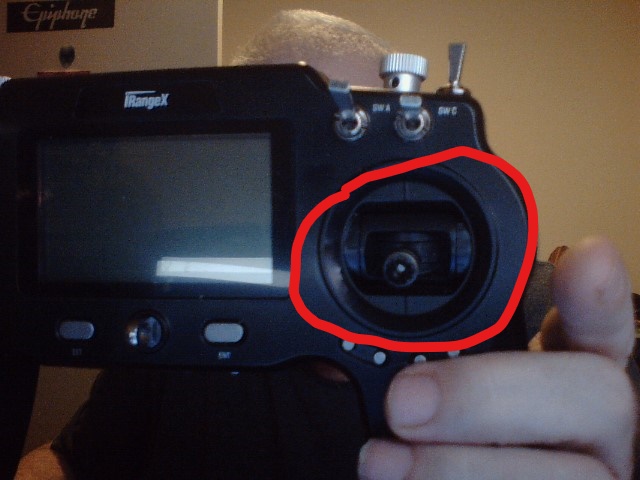

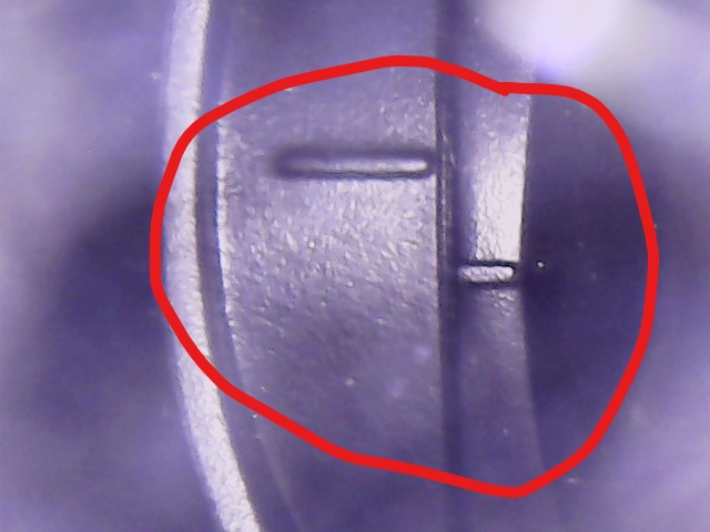

Hi and thank you, I watched the video which is most informative I have quality issues much the same as others. Both gimbals do not centre properly even after numerous attempts at calibration +8 and -17. The right-hand gimbal on my TX when in the home position doesn't even align with the centre markings. My less than favourable review was never published by Banggood my less than favourable comments no bad language just saying much the same as here never published. I am not allowed to post another review for this product because apparently, only people that purchased this product can submit a review. Well, I have my order details proving I purchased this product from Banggood. Only good reviews are currently being allowed on Banggood for this product. Anyway, I've been in correspondence with Banggood and have asked them to send me a replacement Gimbal Kit. I know the state of my purchased product if I can get replacement gimbals good ones from Banggood better still compatible gimbals of higher quality this would become a nice usable TX. I just love the DeviationTX platform its so easy when I'm in a rush to fly compared to open source TX on my Taranis. Regards, Stefan
