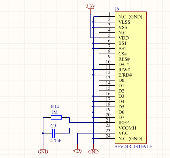

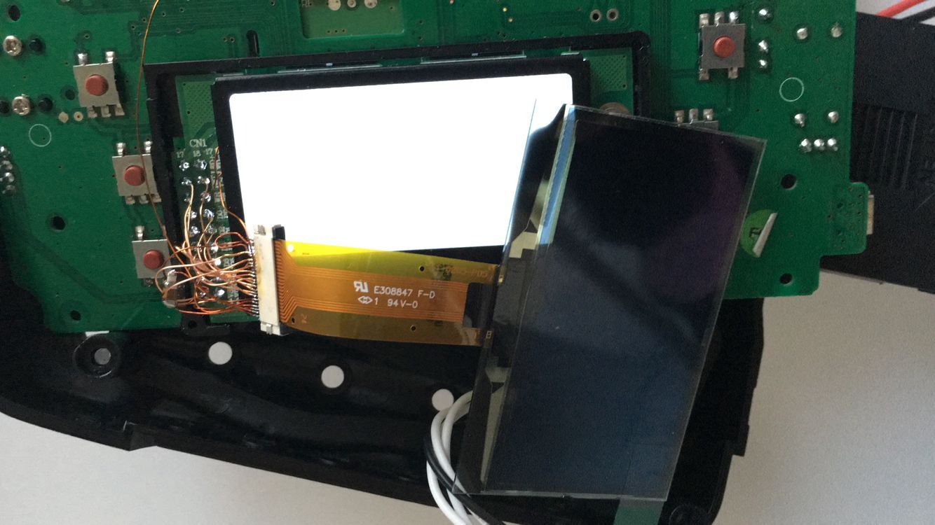

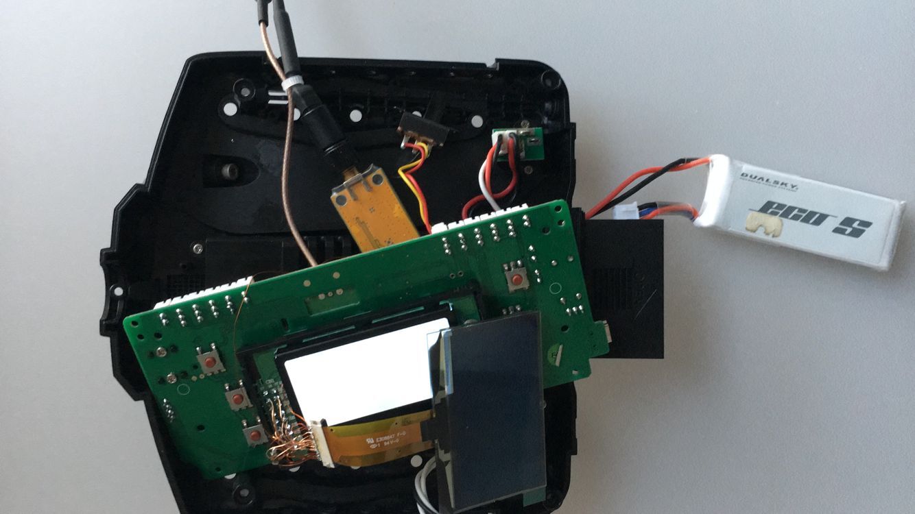

31 Oct 2017 09:35 #65377 by dc59
Jumper tried to install a 2.4 inch OLED to Devo7E , but it doesn't work , can anyone help to build a correct firmware?
They follow this post :
www.deviationtx.com/forum/7-development/...-screen?limitstart=0
and try to modify LCD.C , but they failed.
File Attachment:
File Name: SSD1309-Re...n1.1.pdf
File Size:1,761 KB
File Attachment:
File Name: 286495E.zip
File Size:10 KB
File Attachment:
File Name: UG-2864ASY...0-31.pdf
File Size:357 KB
OLED data sheet is attached.

01 Nov 2017 00:27 #65389 by dc59
Connection of Jumper's OLED pin out.

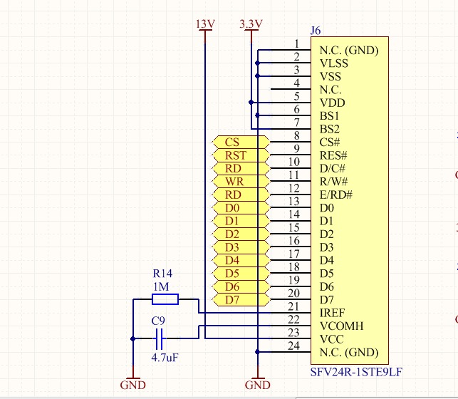

01 Nov 2017 04:41 #65392 by norulers
Replied by norulers on topic New TX from Banggood
New schematic
